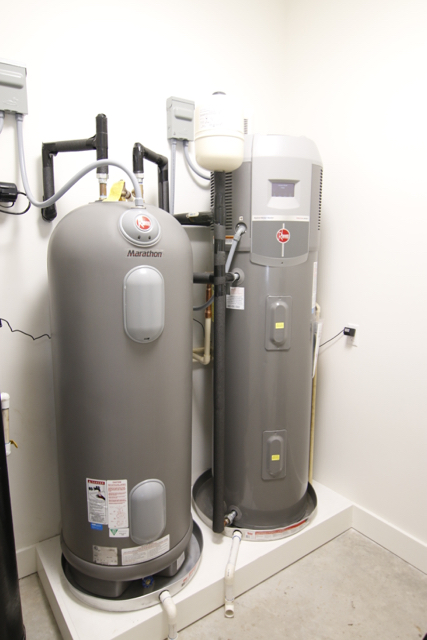

I installed my first Rheem HP50 Hybrid Heat Pump water heater in 2009, and that first unit has been fantastic for my clients. I’ve tried several models over the last six years (including one that’s no longer made), but the biggest downfall of these heat-pump units is their capacity. You really want to run your unit in Heat Pump Only mode for maximum savings, and the heat pump takes a while to refresh a drained tank. I estimate a typical 50-gallon unit has about 30 minutes of showering before it’s drained, and that can be tight if you need back-to-back showers, or if you fill a tub, then want to shower in the next hour.
Let me show you how I used the newest Rheem model in a novel way to solve this capacity issue.
I just completed a Lake House for clients who are nearing retirement. Most of the time, there are only two people in the house, but since it’s a lakefront house, they get a huge influx of visitors on summer weekends. One normal tank wasn’t going to cut it for those weekends with guests. Here’s my solution for an ultimate hot water setup!
Rheem Hybrid Heat Pump 50 Gallon Electric + Rheem Marathon 50 Gallon Electric = 100 gallons of standing hot water, plus both units have electric resistance backups if you had a big need for hot water and didn’t want to wait for the heat pump to cycle!
Here’s the setup: The Heat Pump water heater is first to get the water from the outside. It is set for Heat Pump Only Mode.
The Rheem Marathon 50 Gallon tank is next in line. It’s basically being used as a storage tank. I like the Marathon unit because it’s a super-insulated “Yeti Cooler” thanks to it’s 2.5″ of polyurethane foam. The Marathon is so well insulated it loses only 5 degrees F over a 24-hour period! The Marathon is getting 120-degree water from the Hybrid Heat Pump Water Heater.
Why this works:
1. The Rheem Hybrid unit when operating on Heat Pump Only mode is super-efficient. It has an EF rating of 2.4, which means it’s 240% more efficient than a standard resistance electric heater! But the down side is that the recovery time isn’t particularly fast. That’s where the Marathon tank is necessary. We now basically have a 100-gallon Heat Pump water heater that has two backup electric resistance elements.
2. This combination also means that we don’t have to run a costly gas line (or maintain a propane tank), plus we don’t need to poke a hole in our roof for the vent. Both of these mean fewer penetrations in my envelope and a reduction in the possibility of air or water leaks.
3. The byproduct of running the Heat Pump water heater is cool / dehumidified air. We installed a pass-through vent to the laundry room behind, then used a 50 cfm Panasonic vent fan with a 24-hour timer to periodically move the cold air out of this closet into our house (this closet is inside the thermal envelope).
4. Redundancy! I love that we have some redundancy in our system. If one unit fails, the other can do the water heating until it gets serviced. This is always a plus when you are a builder who is striving for an impeccable service reputation.
