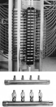

PEX systems can be used as parallel distribution — frequently called a “home run piping system” — consisting of a central manifold with individual tubes running to each fixture outlet (below).
Figure: Piping Manifolds
Standard manifolds are available from PEX suppliers (top), but plumbers who know what they’re doing often prefer to make their own from copper pipe and brass fittings (above) because they cost less and provide more flexibility.

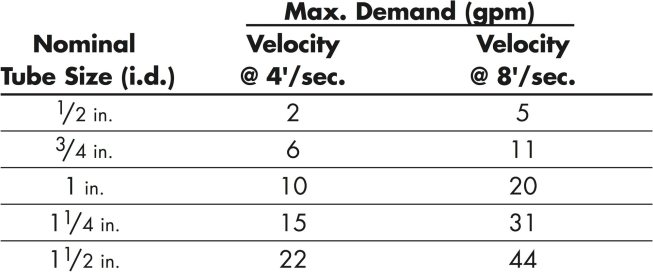

Sizing Manifold Systems
In a parallel water-distribution system, such as a PEX system, the home-run is sized by the water demand of all the fixtures on the system in gallons per minute, not by fixture-unit values.
Sizing the manifold supply. To determine the size of the pipe supplying the manifold, add up the flow rates shown in Design Flow Rates of Residential Fixtures, below, for all the fixtures on the system. Once the total flow rate is known, consult the Manifold Sizing table, below.
Sizing distribution runs. Most manifold systems have individual tubing runs between the manifold and each fixture. The IRC allows a minimum size of 3/8 in. for distribution lines in a manifold system, though some toilets, whirlpools and other fixtures may require larger supply lines (as specified by the manufacturer).

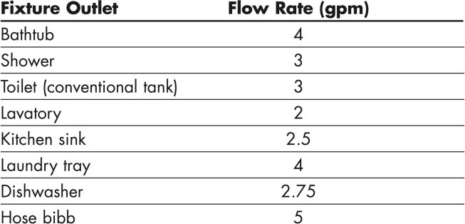

Figure: Design Flow Rates of Residential Fixtures
The required capacity for the supply pipe outlet varies for residential fixtures. All flow rates shown assume a dynamic flow pressure of 8 psi.
Figure: Manifold Sizing
The supply pipe for a hot- and cold-water manifold is sized according to the total demand in gallons per minute for all the fixtures on the manifold. Individual fixture demand can be found in Design Flow Rates of Residential Fixtures, above.

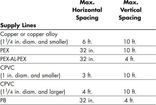

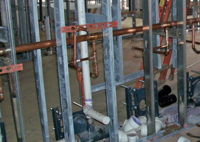

Pipe Support
All plumbing lines running horizontally and vertically inside a building must be supported at intervals with hangers. Maximum distances between supports are shown below.
Figure: Supply Pipe Support
Note: Copper pipe must be supported with hangers that do not promote galvanic action, which will cause corrosion.
