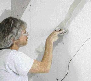

Often you can't tell how bad a crack is until you cut it open. Plaster is brutal on sharp edges, so I use two different cutting tools for this process. First, I use a standard utility knife, to separate the paint and the top layer of plaster. The blade gets dull fast, but a few passes across a pocket-sized whetstone restores enough of an edge to keep working.
To fashion a strong bond between patch and plaster, it's important to widen each crack and undercut the edges to form a key. The author uses a replaceable utility knife blade to make the initial incision, breaking through the paint layers and the hard, top layer of plaster.
He then employs a crack opener from Hyde Tools to enlarge the crack and undercut the edges.
After the first incision, I reach for a small hand tool called a crack opener (www.hydetools.com, 800/872-4933) to scrape out loose plaster and undercut the edges of the crack. A "church key" or a painter's 5-in-1 can be equally effective, but since the crack opener is made from high-carbon steel, it stays sharp much longer. When it does get dull, I have a Dremel nearby, set up with a mini-grinding wheel, to restore the edge.
Power tools, such as a RotoZip or a minigrinder, are also effective options for excavating plaster cracks, but they must be used with care, because they're very messy. Also, they carve through sound plaster almost as fast as through the damaged stuff, so it can be hard to know where to stop. When I'm using a hand scraper and meet up with sound plaster, I know it instantly.
