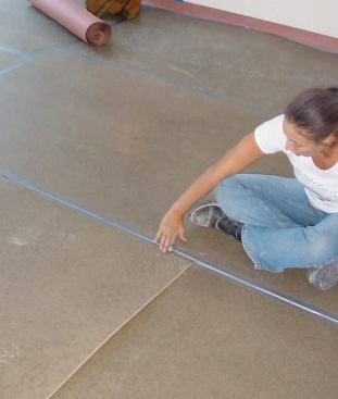

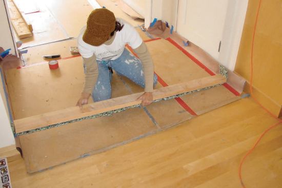

The traditional practice of “protecting” finished floors from falling lumber, debris, and tools with a thin painter’s drop cloth just isn’t effective, so we use 1/4-inch hardboard. This is duct-taped together at the seams and sealed at the edges with a border of rosin paper. In our area, hardboard runs about $8 per sheet, and most sheets last us about four or five jobs.

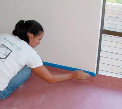

Laying down the rosin paper. After thoroughly vacuuming the floor, we roll out a full-width sheet of rosin paper around the room, form a crease a few inches from the edge nearest the wall, then fasten the creased edge to the wall below the height of the existing baseboard with blue painter’s tape. This ensures that the wall above the base is not damaged by the removal of the tape at a later date. The corners are a little tricky, but they can be folded so that they sit tight to the wall. Even though it would be easier, it’s important not to tape the rosin paper to the finished floor, as it might peel off the floor finish when it’s removed.
Hardboard and duct tape. Once the rosin paper is installed, we lay down the hardboard. We use full 4×8 sheets where we can, but where accessibility is tight, we gang-rip the sheets down to 4×4 or 2×8. The perimeter sheets are held about 2 inches away from walls and cabinetry. This lets us remove the old baseboard and install new base by folding back the rosin paper, temporarily taping it to the hardboard, and then reapplying it when we’re done.
Over the rest of the floor, the majority of the sheets are butted together and joined with a single layer of duct tape. To avoid having to cut too many of the remaining sheets, we overlap where we can — these overlapped layers are joined with a double layer of tape, lapped about an inch. It’s worth using good-quality duct tape, such as Nashua 333 — the cheap kind tends to come apart, making it hard to remove later. The whole floor can now be worked on safely and is easily cleaned.

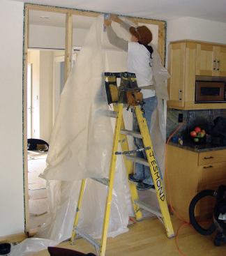

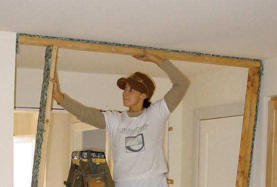

We build temporary walls with access doors at any area along the work path that needs to be isolated from dust. Especially in homes with open plans, a temporary “room within a room” can serve as an ideal cutting space and a storage area for tools and materials. Also, even though it’s difficult to prevent bored or curious homeowners from looking in on the progress of the job, making them pass through a temporary door to reach the work area at least reminds them that they’re now in your space.
Pressure-fitted framing. The temporary walls consist of a frame of 2x4s with strips of sill seal or carpet padding stapled to them. The framing has to be cut accurately, because the finished wall is held in place by pressure only — we don’t drive any fasteners all the way through the framing. This avoids the need to repair holes in the existing interior finishes later.
Once we’ve determined where the walls will go, we measure for the plates; the thickness of baseboards means that the bottom plate is typically 1 1/2 inches shorter than the top plate.
We also subtract 1 inch from the overall length of both plates to allow for the thickness of the sill seal that will later be folded up at each end.
We ordinarily space the studs about 3 feet apart on-center. The exact spacing isn’t important, but the length is: The floor-to-ceiling height often varies along the length of the wall, so we don’t gang-cut the studs. Instead, we lay out the plates and take separate measurements for each, after stacking the top and bottom plates on top of each other.
Once the studs are cut to length, we staple a layer of sill seal to all the perimeter framing. To erect the wall, we position the top and bottom plates, tap the endmost studs into place between them, and toe-screw them to the plates with 2-inch screws. If the studs have been cut accurately, the frame is held firmly in place as we screw in the remaining studs.

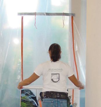

Temporary doors. Stick-on zipper doors are easy to install. They’re fine for areas that don’t see a lot of traffic, but they don’t stand up well to regular daily use. Frequently used openings get a regular hollow-core door instead.
We use 3-0 x 6-8 prehung doors equipped with foam weatherstripping, a strip of sill seal as a sweep, one self-closing hinge, and a drop-down doorstop. The 3-0 width and doorstop make it easier to move large items in and out. The weatherstripping and sweep help keep the dust inside the work area, as does the uncut bottom plate. The self-closing hinge saves us having to check that the door is kept closed. If the client has small children, we use a door with key-lockable hardware and lock it when we leave for the day. We hang the key high on the wall next to the door, so the client can get into the space if need be.
Once the door is installed, the wall is finished with a layer of 6-mil clear plastic stapled across the entire wall, including the doorway. The plastic goes on the side of the wall that faces the living space because it looks neater to the client that way. The plastic is then cut out and taped to the inside of the jambs with white tape.

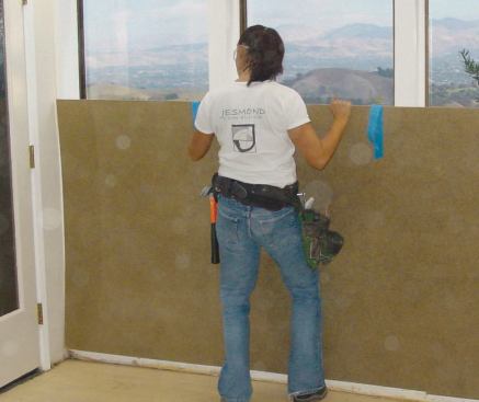

To protect walls and tall windows in the demo area, we have a few different options depending on the situation. We have experimented with covering wallpapers or delicate finishes with plastic sheeting alone to keep off dust, but they can still get bumped or scratched. They’re best protected by building a temporary wall right in front of them. The temporary walls also give us the option of leaning sheet goods up against them without damaging the wall behind.

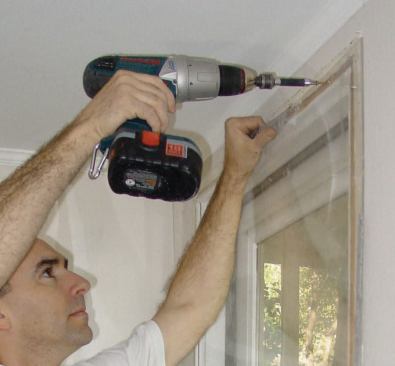

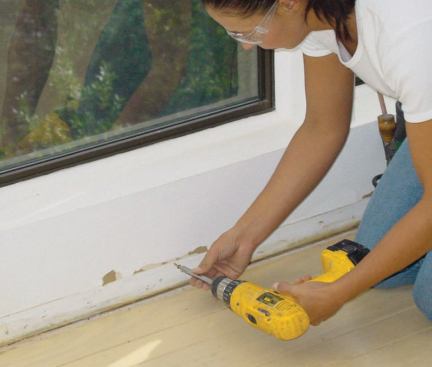

Low windows. We’ve found that windows close to flooring that will be demolished are best protected with sheets of hardboard. After removing the baseboard, we install 2-inch screws into the wall just below the top of where the new base will eventually be, spaced two or three studs apart. The hardboard sits horizontally up on the screws and is taped to the wall with a small amount of blue tape, or pin nails. This doesn’t interfere with removing the old floor, and the screw holes in the wall are concealed by the new baseboard.

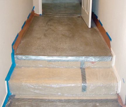

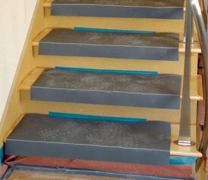

Carpeted stairs are covered completely with a layer of sticky roll plastic from Pro-Tect, which is replaced once a month. Hardwood stair treads are protected with a product called Pro Tecta Top from Protective Products. This is a heavy sheet plastic with a foam backing that we cut to fit the depth of the tread, and tape to the risers with blue tape.

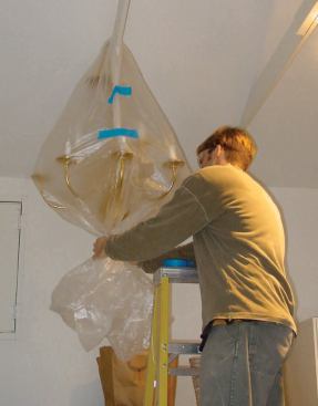

As with existing doors, chandeliers and other hanging light fixtures directly in the work area are best removed. Even if you manage to avoid breaking them, they’re sure to get dusty, and cleaning even a small chandelier is a time-consuming chore we prefer to avoid. After carefully removing the fixture, we hang it from the ceiling in the garage. It is then draped loosely in plastic, which is taped to itself at bottom and top.

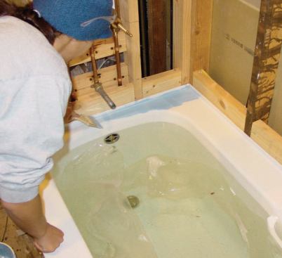

Bathtubs and shower pans are protected with Pro-Tect Liquid Mask, a water-based material that sets up to form a tough, rubbery coating. We apply it to the perimeter of the tub with a brush; more than one coat is usually required to build up an adequate thickness.

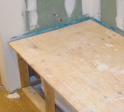

Next, we cover the top of the tub with a sheet of 3/4-inch plywood that’s the same width as the tub but 2 1/2 inches shorter than its length. Dimensioning the cover in this way leaves a gap of a little over an inch at each end; the plywood is allowed to overhang the apron enough to leave a corresponding gap between its long edge and the wall. The edges of the plywood are then duct-taped to the Liquid Mask. When the tile sub is ready to install the wall tile, the Liquid Mask is peeled back enough to permit setting the tile without removing the plywood.
To protect nonremovable tub aprons, we cut another piece of 3/4-inch plywood to the same length as the top cover and about 3 inches shorter than the height of the apron. We place it against the apron and screw it from above, through the overhanging top cover. This covers the easily damaged apron almost completely, but because the plywood doesn’t extend all the way to the floor, it’s possible to install the finish floor without removing it.

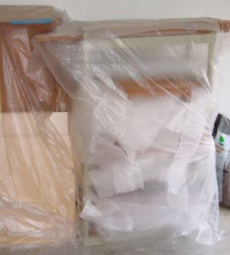

Drawers, doors, and countertops. Cabinetry and countertops are subjected to all kinds of abuse during construction. Before installing cabinets, we remove all the doors, drawers, and end panels and store them out of harm’s way. Most of the cabinetry we install uses easily removable European-style hinges, so this is a simple task. Newly installed cabinets with inset doors are checked for square and racking with the doors in place before they’re stored away.
We bring lots of knock-down hard-plastic shelving racks to our jobs to organize tools and materials, and these are also ideal for storing doors and drawers. We use strips of packaging material like corrugated cardboard and foam as spacers between doors and drawers, and the whole stack is covered with plastic sheeting.
The doors, drawers, and removable end panels remain safely in storage until the very end of the job, just prior to installation of the knobs and pulls.
