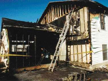

Securing the Site
Since nobody plans for a fire, restoration jobs come ad hoc, sometimes on Sunday, often in the middle of the night. Usually an adjuster or insurance agent calls with an address and a general description of the disaster. By the time I arrive, the fire department has done its job; my part involves first making a preliminary damage assessment and then securing the building.
Since I have to be ready to roll whenever the call comes, I keep some basic gear in my truck, including gloves, a dust mask, a flashlight, a pry bar, and a folding ladder. I wear thick-soled boots to protect my feet from broken glass and other sharp wreckage, and stock disposable coveralls in the cab to shield my clothing from soot stains and smoke odors. Sometimes I rub Vaseline on my face and hands so I can wash off the stench without having to remove a layer of skin.
As soon as I arrive at the job site, I walk around the building to assess structural damage. I look for broken windows and doors, holes in the exterior walls, and damage to the roof. If I find any of these conditions, I radio my employees. A specialized board-up crew installs 1/2-inch plywood and reinforced polyethylene sheets wherever rain, wind, or mischief-makers could get in.
I check the utilities, too. Though the fire department usually contacts the electric, gas, and water companies to disconnect their services, I have discovered downed power lines, leaking gas pipes, open water mains, and other hazards requiring immediate attention.
Once I’ve determined that the perimeter is secure and the building appears safe to enter, I try to find access into the basement. This allows me to inspect the floor joists and stairs from below. Fire travels up, so it’s sometimes necessary to shore up a few joists before it’s safe to walk around.
Because there’s usually no power on the site, members of my crew carry battery-powered tools, flashlights, kerosene heaters, and a portable generator. To keep the workers safe, I supply them with hard-hats, respirators, disposable coveralls, heavy-duty gloves, and safety glasses, and I insist they wear heavy-soled steel-toe boots and sturdy work clothes with long pant legs and long sleeves. Their first job is to secure the building, eliminate dangerous conditions, and drain plumbing lines. Sometimes they’ll mop floors and pump out standing water. If I suspect that hazardous materials are present, such as lead paint or asbestos, I hire qualified technicians to test for them and, if necessary, remove them before we proceed further.

The extent of structural damage depends on how hot the fire was and how long it burned. Structural steel, masonry, and sheet metal expand and weaken in the presence of heat. It’s not unusual for steel headers and beams to collapse. Roof trusses dry out and shrink when exposed to intense heat. Even if they haven’t caught fire, this shrinkage can loosen truss plates and weaken the roof structure.
You can’t accurately assess structural damage without first mapping the exact route the fire could have taken. Flames can race up between studs and destroy a portion of the roof while leaving the walls apparently intact. Floor joists can burn to the point of failure while hidden behind a drywalled ceiling. And even when a fire isn’t hot enough to burn through wood framing, it’s still possible for wire sheathing and flexible ducts to have melted in joist and stud bays. So, in order to determine if flames went up through balloon framing, into chases, and across drop ceilings, I try to make a visual inspection of the entire fire path, even if this requires removing drywall. I crawl into the attic, climb onto the roof, and peer down the chimney.
When the framing is charred, I try to determine how deeply the fire has burned through it. As a guide, I refer to the Uniform Building Code’s notching standards for structural members. Charring at the top or bottom of a joist, for example, shouldn’t exceed one-sixth the depth of the joist. Load-bearing studs can’t be charred more than one-fourth their width. My rule of thumb is that any damaged framing that falls within these limits can stay, requiring only cleaning and bracing; framing burned beyond these limits gets replaced.
Some structural systems can fail even when wood members haven’t burned at all. The metal clips that hold an engineered truss together can loosen with even moderate heat, dangerously weakening the entire structure. If I have questions, especially on roof trusses or engineered floor systems, I don’t hesitate to get advice from my building inspector or a structural engineer.
