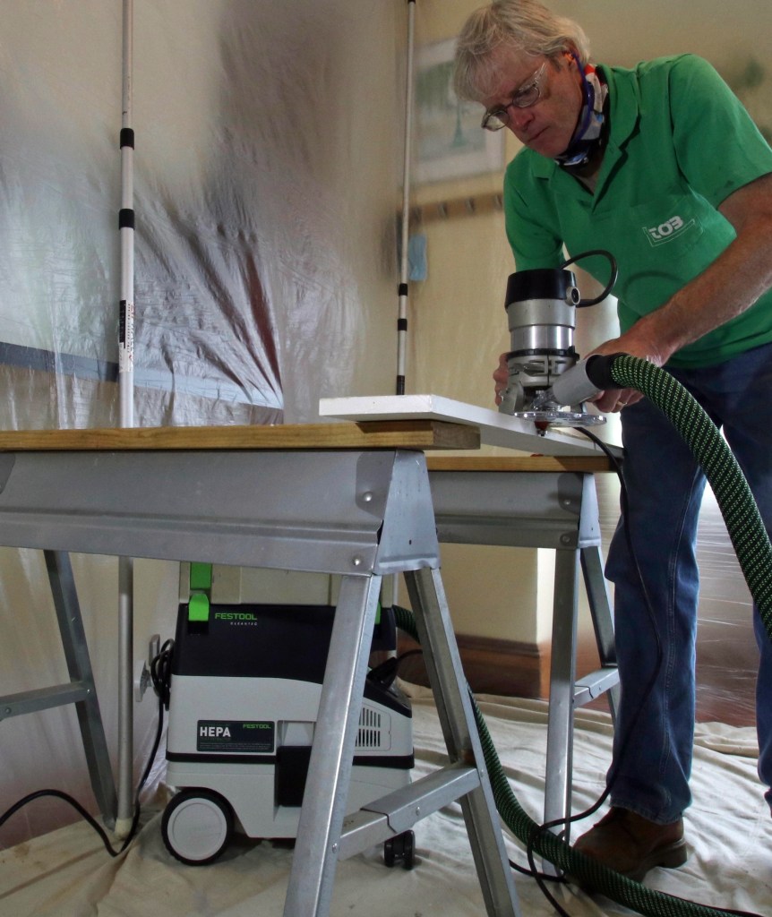

  • Use shrouded power tools connected to HEPA vacs to capture dust at the source.
  • Use air scrubbers to capture whatever gets away, and provide good separation between the work area and occupied areas of the building to ensure air between them does not mix.

Rob Robillard, owner of A Concord Carpenter, follows an all-of-the-above approach to keeping the air clean. “We’re using air scrubbers when it makes sense, we’re using ZipWalls when it makes sense, we’re collecting dust at the source, and we’re vacuuming with HEPA vacs, sometimes multiple times a day, to keep the dust down.”

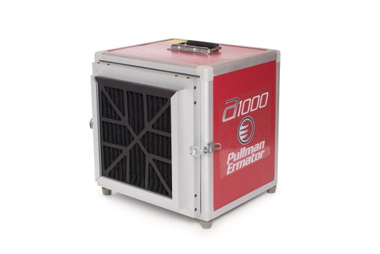

“Air scrubbers” are designed to sit in the middle of a work area and pull air through a cyclonic extractor (as in the Vortex Dust One unit, shown above) or through HEPA filters (as in the Pullman-Ermator A1000, below). When the exhaust is ducted outdoors, an air scrubber can create negative pressure in the work area that can help keep contaminants out of other areas in a building.

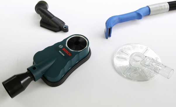

  • Manufacturers have a burgeoning array of attachments that enable workers to work safely at almost every dirty job (even paint-scraping). Shown above (clockwise, from upper left): Festool Drilling Dust Nozzle D 27-BSD; Oneida Air Systems Viper Vacuum Scraper; Oneida Air Systems Dust-Free Router Hood (also shown below); Bosch HDC200 Universal Dust Collection Attachment.

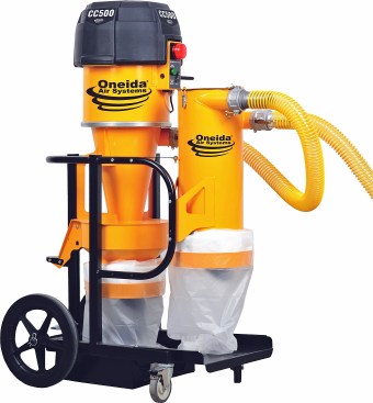

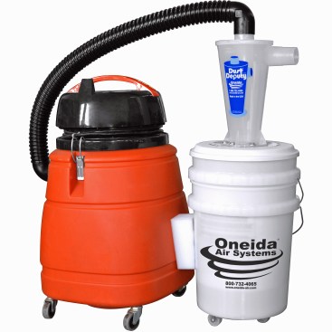

  • Cyclonic dust collectors (staples in woodworking shops) have arrived on the jobsite, both in the form of standalone units, and as pre-sorters for HEPA vacs—to separate out the larger dust particles so they don’t clog the filter.
  • Air scrubbers (aka “negative air machines”) have gotten more portable and more affordable.
Cyclonic dust extractors can suck up large volumes of dust without clogging filters. Large stationary units are common in woodworking shops, but there are several portable types available now, as well. Shown above is an inexpensive “add-on” version that allows you to use your own vacuum. Below is a heavy-duty, "all-in-one" cyclonic dust extractor is designed to contain silica.

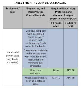

In this excerpt from Table 1, if a worker uses a saw outdoors for four hours or less per day, no respirator would be needed. If a worker uses a saw for more than four hours per day or any time indoors, he or she would need to use a respirator with an assigned protection factor (APF) of at least 10. A NIOSH-certified filtering facepiece respirator would provide this.
Employers who adhere to the general mandates of the silica rule and follow the methods prescribed in Table 1 have no further obligation to prove the effectiveness of their silica safety plans. “If you follow the script, use the wet methods, use the dust collection systems, or whatever it may be, there’s no need for air monitoring,” says Tucker.

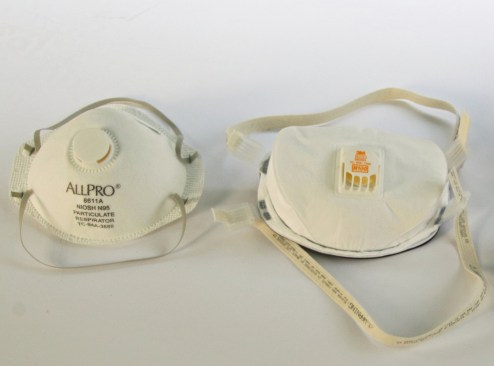

A NIOSH-approved disposable filtering facepiece respirator (FFR), such as an N95 (above left) or N100 (above right)  can be used for protecting workers from particulates, but not vapors and gases. These models have adjustable double head straps, which provide a better seal than the ear loops found on KN95s.

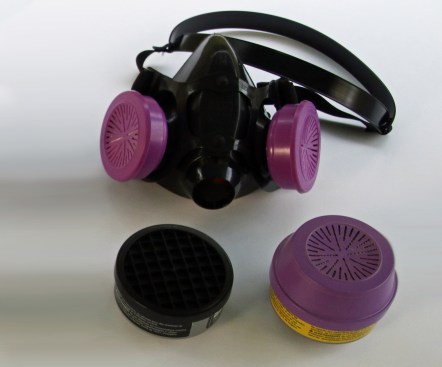

A reusable half-mask respirator (shown above) with the right color-coded filter (below) can protect workers from particles as well as hazardous vapors or gases.
A full-face reusable respirator (the kind that looks like a gas mask) can achieve an APF of 50. Although APFs range as high as 10,000, anything over 50 requires battery power or supplied air.
FFRs are only suitable to filter particles (dusts, mists, or fumes). They are classified by a letter, which refers to oil-resistance, followed by a number, which designates filtration capability. The N95 that we hear so much about these days is not oil-proof, and is designed to filter 95% of airborne particulates. An R95 is oil-resistant; a P95 is oil-proof. An N, R, or P100 can filter 99.7% of particulates and qualifies as HEPA.

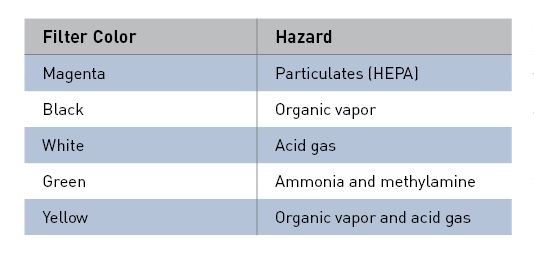

Contaminants other than particulates require a reusable respirator with replaceable cartridge filters, which are color-coded by the hazard they protect against (see table, above).

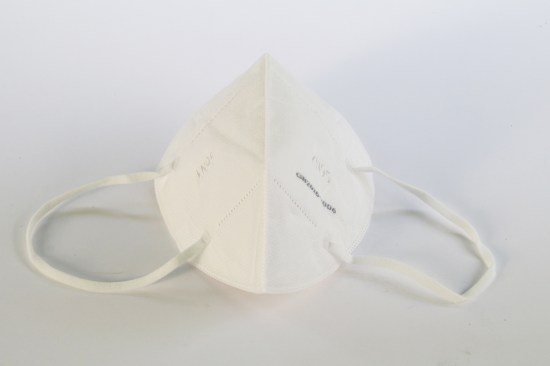

A KN95 respirator is the Chinese equivalent of an N95. The filtering element is equally effective, but one area of concern is that most KN95s have ear loops, rather than adjustable head straps, which make achieving a tight fit to the face more difficult.
