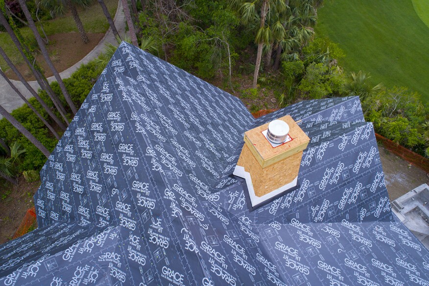

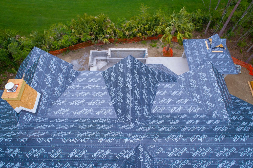

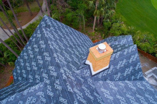

Underlayment is Crucial
If any water does get behind the panels (whether from installation errors or leaks caused by falling branches) it can work its way into the sheathing around those screw penetrations.
That's where a high quality, peel-and-stick underlayment membrane earns its keep. It provides a backup watershed and also self-seals around screws.
Some installers only extend the membrane 36 inches up from the exterior wall line, as required by code, then lay roofing felt above that. This protects the roof edge against leaks caused by ice dams, but if water gets behind the metal on the upper part of the roof, remember that felt has no sealing ability.
Underlayments Aren't Equal
Although you can use a standard peel-and-stick membrane, some builders and architects want more protection. The issue is heat: underlayment beneath a metal roof will get hotter in the sun than under asphalt shingles.
"We make a membrane for metal roofs called Ice & Water Shield HT. It's a 40 mil rubberized asphalt that has been tweaked to give it better thermal stability," says Brandon Wulf, a Sales Manager at GCP Applied Technologies. "The HT product is formulated slightly differently to achieve a higher thermal stability."
Some roofs get even hotter. That's the case with copper panels, which absorb more sunlight than steel, and in extreme climates like Arizona. "In those cases, we recommend Grace Ultra," says Wulf. "It's 100 percent butyl rubber with a thermal stability up to 300 degrees."
