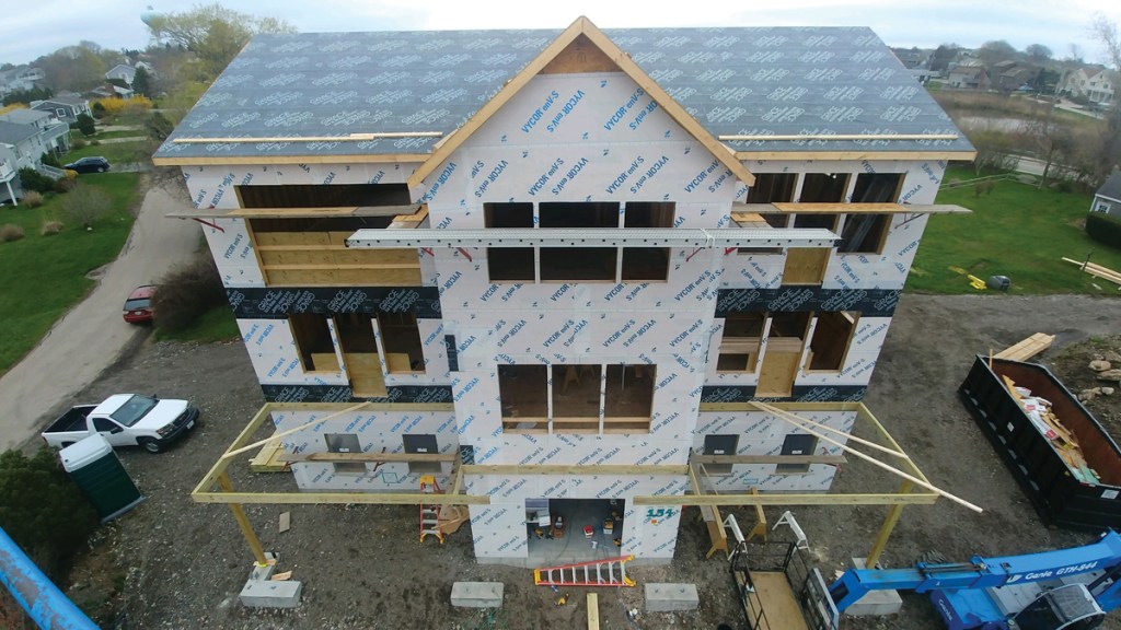

Air leakage is a major cause of moisture intrusion, setting up the conditions for mold growth. A properly installed, continuous air barrier can minimize this leakage and dramatically reduce moisture intrusion through wall structures. The goal is to deny the outside air—and the moisture it contains—any point of entry.
Rain resistance
A new generation of vapor permeable fluid-applied air barriers offers early rain resistance. Soon after application, the membrane can withstand a light rain, preserving your investment in time, labor and material. As the fluid is applied, a chemical reaction occurs that begins curing the material rapidly, resulting in light rain resistance.
Rain-resistant air barriers are particularly valuable for use in climates where rain is a constant companion—from the Pacific Northwest to the East coast. But even in less extreme climates, rain can threaten project schedules. Using a rain-resistant air barrier may help avoid financial liabilities due to project delays, which means one less potential problem to worry about.
