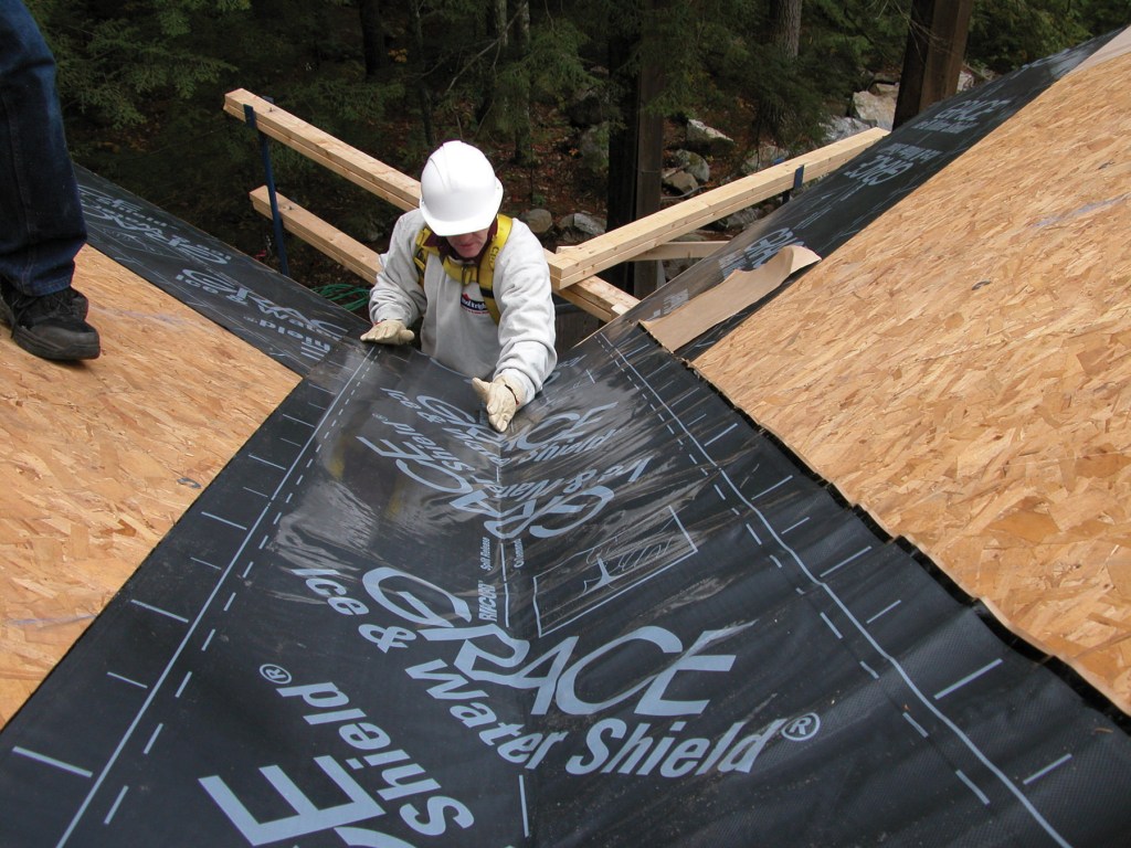

However, contractors are increasingly using unvented assemblies with insulation that is directly in contact with the roof deck. This creates a high amount of stress on the roofing underlayment because the heat essentially has nowhere to go. This drives up the surface temperature of the roof.
If the roof becomes too hot, the adhesive used in the self-adhered roofing underlayment may soften. This can result in sticky adhesive dripping onto the exterior of the building or finding its way into gaps in the roof sheathing or plywood and getting into the building itself.

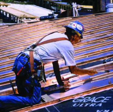

In most cases where there is a vented roofing assembly, a standard roofing underlayment will have the sufficient heat resistance to prevent this. However, if the roofing design is likely to result in a more extreme in-service temperature, it’s safer to switch to a roofing underlayment designed for high temperature. In these cases, the roofing adhesive has been modified to perform in high heat, without softening. These high temperature (HT) products are generally designed to perform up to 240° F. There are also certain situations, (such as with copper or zinc roofs with unvented roof assemblies), that call for roofing underlayments with butyl adhesive, which are designed to perform up to 300°F.
