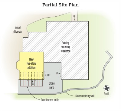

New two-story addition changed the home’s original L-shaped building footprint to an upside down U-shaped one.
Central to the project is a two-story addition with a kitchen on the first floor and a bedroom on the second. In plan view, the addition forms what is essentially a new east wing, which changes the home’s previous L-shaped building footprint to a U-shaped one. The existing west “wing” is a section of the home that we’re renovating; it contains a new first-floor sitting room and remodeled second-floor master bathroom. The two wings are separated by a new stone patio area. (See “Partial Site Plan”.)

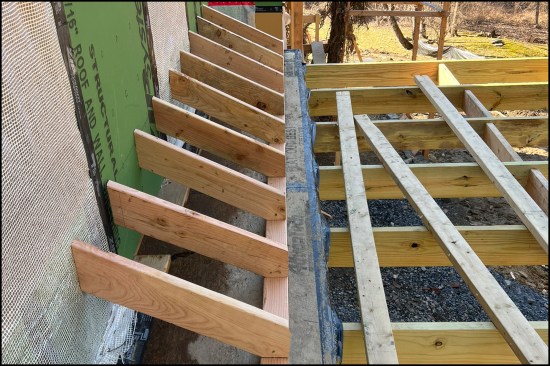

An interesting feature of the addition is a trellis that projects out from its north-facing end wall. Framed with pressure-treated 2x10s sistered onto the second-floor framing, the trellis cantilevers out 7 feet. To support the cantilever, we ran the trellis framing 14 feet back into the building and secured it to the floor joists with a tight on-center pattern of 12-gauge framing nails and 3-inch LedgerLok screws. (Mahogany will cover the trellis’s framing, and steel cables will run up from grade to allow vines to grow onto the structure.)

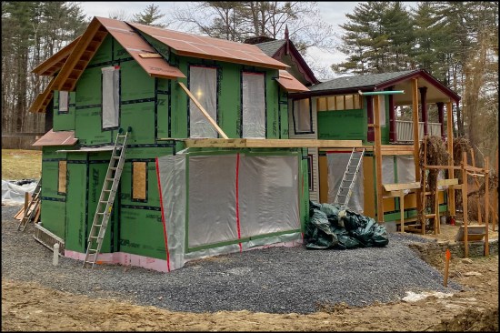

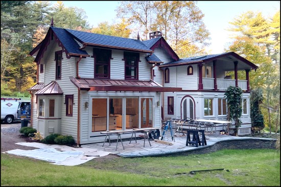

Design problem. While we were framing the addition’s roof, the homeowners visited the jobsite and noted that the addition looked too big and its height competed with the height of the main house. Also, they didn’t like how the sight lines from the remodeled second-floor bathroom window would be blocked by the addition. We had framed the addition according to the design plans, so the architect was brought in to look for ways to reduce the mass of the addition.
The clients felt that the addition’s mass (in the foreground) was too big and its height competed with the main home’s height.

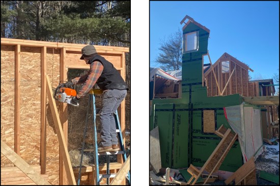

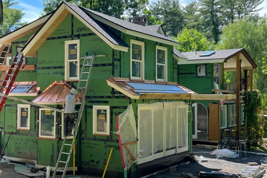

Framing “do-over.” We demoed the gable and shed-dormer end walls, then reframed the second-floor walls and roof, stepping the shed-dormer wall 3 feet back from the first-floor’s exterior wall. Next, we started on the “mass-reducing” roof, framing it on top of the second floor’s 3-foot-wide, now-exposed deck.

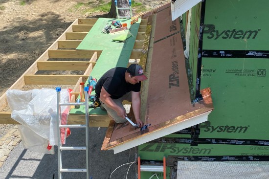

A small 2x6 framed roof was installed the second-floor deck, the framing held back from the edge to allow for the placement of the 19 1/2-foot-long rough gutter.

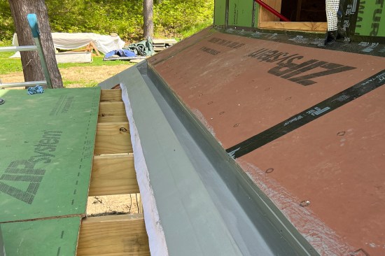

Finishing up, we bevel-cut the side walls to match the 4:12 roof slope (resulting in a 7-inch-high back wall and a roughly 5 1/4-inch front wall, as measured from the interior at the gutter’s high point), then joined the two trough sections at the center high point and installed 1-by tapered pieces at each end. We lifted the completed gutter in place, checked it for straightness, and fastened it to the outer edge of exposed strip of the second-floor deck.

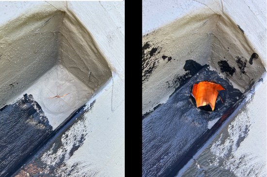

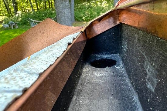

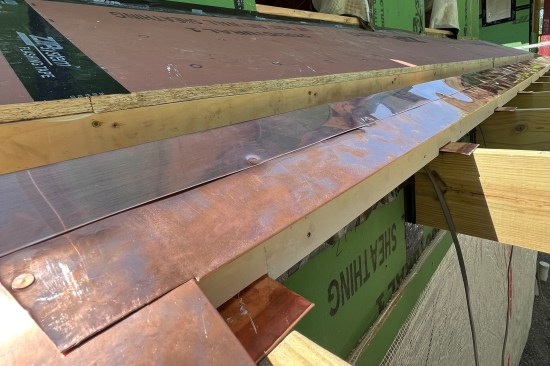

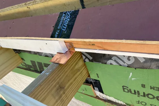

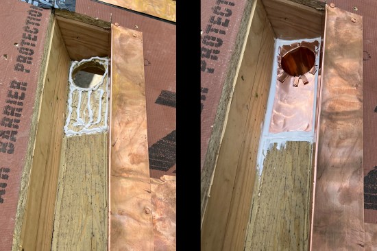

We framed the small roof with 2x6 rafters, attaching them to the back wall of the built-in gutter at the eaves and a ledger fastened to the stepped-back shed-dormer wall. After sheathing and taping the roof, we ran site-bent 16-ounce copper edge flashing around its perimeter. (The homeowners decided they wanted to dress up the lower roofs with copper; the upper roofs were asphalt shingle.) Then, we flashed the downslope edge of the gutter with copper and custom-built copper drop tubes, one for each end. Prior to installing the two-piece drop tubes, we routed out the 1-by bottom about 1/8 inch to plane the flashing in to the rough gutter to avoid ponding, then set the flanges in Sikaflex.

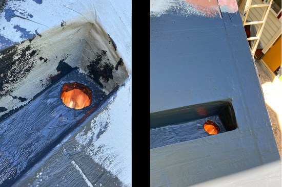

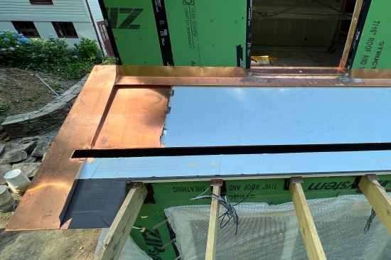

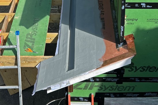

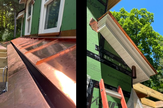

Lining the trough. While metal-lined gutters are known for their longevity, they are not maintenance-free; soldered seams can fracture from expansion and contraction. We chose instead to line the gutter with Acrylabs, which is a less-costly, solderless alternative to a copper lining. Acrylabs is a seamless, fluid-applied acrylic elastomeric roof system that our company has used on a number of roofing projects (see “A Versatile Fluid-Applied Roofing Solution,” Nov/Dec/20). The system consists of a tack coat (with reinforcing fabric set into it), a saturation coat, and two finish coats that dry to an approximate 45-mil thickness.
We first applied the two-coat base with reinforcing fabric to the trough and downslope portions of the gutter (also covering the small roof areas on either side of the trellis framing). We let each coat dry before applying the next. Then, we applied the Acrylabs reinforced base coat to the upslope, running it 18 inches up the roof. We applied the two finish coats, using a dark-colored finish coat to help hide the gutter.
Finishing up the roof, we laid down a high-temperature underlayment, then installed a copper apron along the roof-to-wall intersection. We integrated windowsill pan flashing into the apron, soldering the seams, then began applying the 16-ounce copper standing-seam panels, working left to right. Copper downspouts will be installed later, as well as a copper gutter and downspout on the shed-dormer roof above.

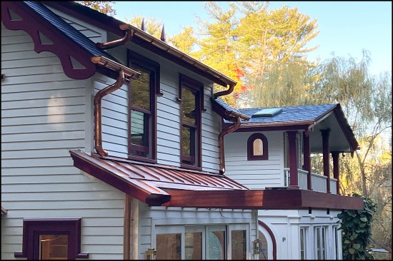

The completed Carpenter Gothic-inspired addition with stepped back second-floor wall. The sight lines from the second-floor bathroom archtop window in the remodeled portion of the existing home no longer blocked.
The copper roof, built-in gutter, and mahogany trellis installed.
