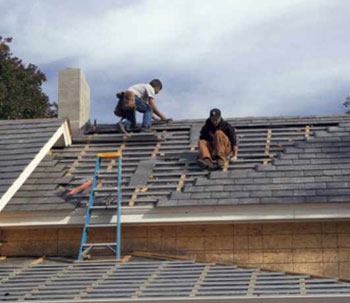

Safer. A Nu-lok roof is also safer to install than an asphalt roof. Once the horizontal battens are in place, they act like a ladder; it’s like having permanent roof cleats in place every foot up the roof.
Looks the same. After the roof’s installed, you’ll be hard-pressed to tell the difference from a traditional slate roof. Visually, there are two differences, however. One is the larger reveal — 12 inches on a 16-inch slate — vs. around 71/2 inches on a conventional slate roof. The other is the taller drip edge, used to close off the ventilation space. We usually use copper for all the flashings, which darkens and blends in with the slate. Even though I work in an area known for its old slate roofs, no one — neither customers nor anyone looking at the finished jobs — has ever commented on these differences.
Easy repair. We often put on the top two rows of slate early in the job so we can finish capping the ridge without having to fight our way up the slate roof to get to the peak. We can also leave a walking path to anywhere we need access to, because the Nu-lok system makes it easy to remove and replace any slate on the roof. You don’t need any tools: You just slide the spring clips to the side and pull the slate out. To put the slate back in, you reverse the process. This makes repairs easy, too.

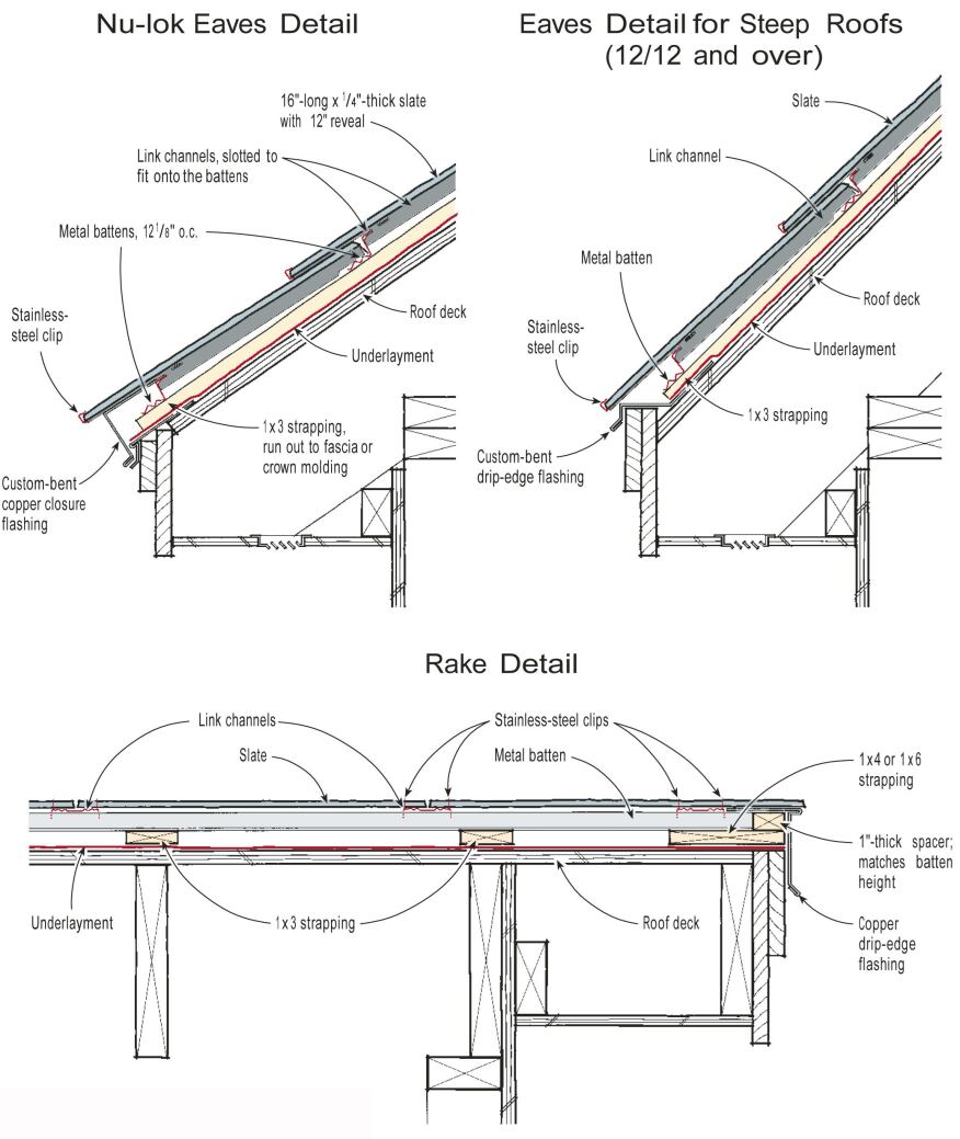

Battens and link channels. The heart of the Nu-lok system is the horizontal Galvalume battens and link channels that support the slate. The metal battens get installed over 1×3 wood strapping nailed through the sheathing to the rafters. This creates an air space under the entire roof, which helps to keep icing to a minimum. It also allows any water that blows or seeps up under the slate to drain down and out at the bottom edge of the roof.
The link channels are vertical pieces, also Galvalume, that are slotted to fit onto the battens; stainless steel clips at the bottom of each link channel support the slate. There’s a link channel between every two field slates. The surface of the link channel acts like a gutter, draining water down onto the surface of the slate below. Both the link channel and the stainless steel clip have a black finish, so they pretty much disappear when you look at the roof from the ground.

Installation Starts With Underlayment
We first apply Grace Ice & Water Shield to the eaves and valleys, and around skylights and plumbing vents. We use the Ice & Water in addition to the boot flashing or any metal flashing that comes with the skylight. On shallow roofs — 4/12 and under — we’ll cover the entire roof.
Next we lay down Grace’s Tri-Flex 30 underlayment over the rest of the roof. We use a Bostitch cap stapler to make this go faster.
At this point, we measure to make sure the roof is square so that we can make up any irregularity with the drip edge. It’s important to have an accurate, square layout with Nu-lok; it’s harder to fudge once slate installation has begun.
Strapping
Next, we nail 1×3 strapping vertically up the roof at each rafter. We typically use 8d galvanized ring-shank nails for this, but we’ve also used stainless nails or screws when the architect requested it. Depending on the overhang detail, we run the strapping out as far as the fascia or crown molding. As with any roofing job, it’s important to have the fascia and crown in place if possible before the roof goes on. This is even more important with Nu-lok because the drip-edge flashings also double as closures for the vent space, so they need to be custom-bent for the conditions.
