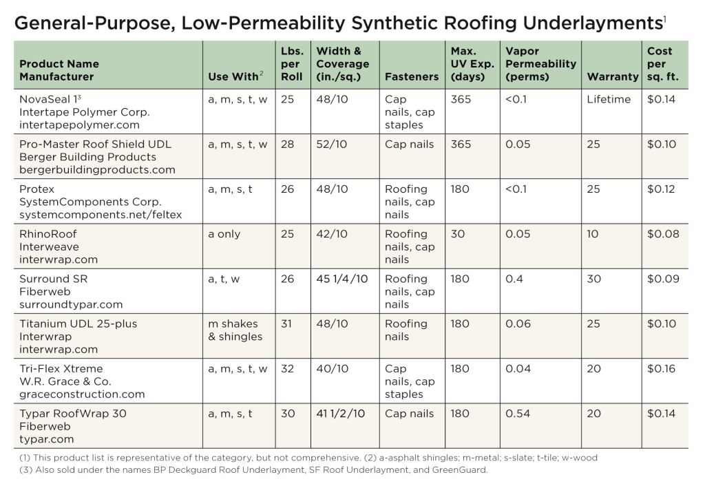

General-Purpose Underlayments. These materials are typically recommended for use with one or more of the common roofing types. Generally they are the lightest weight, least expensive products, and carry shorter warranties.

Not All Synthetic Underlayments Are Created Equal
It’s important to note that while the manufacturers of synthetics tout their most desirable general properties — water-shedding ability, strength, light weight, UV resistance, slip-resistance, and such — not all synthetic underlayments are the same. Some manufacturers make more than one synthetic underlayment, recommending each for a different application. For example, while some products are recommended for use with all common roofing types — asphalt shingles, metals, clay tile, slate, and wood shingles and shakes — others are recommended for only one or two applications, say tile and metals.
In many cases, the product brand names aren’t terribly descriptive in suggesting specific applications or indicating a product’s place in the “good-better-best” hierarchy. For that reason, I’ve tried to sort out key differences among the synthetic underlayments I found in the market, and grouped products with similar properties in each of three tables displayed throughout this article. The fourth table lists high-temperature synthetic underlayments.
Products I’ve listed as “General-Purpose” are the lightest, least-expensive materials, and carry the shortest warranties. They are typically recommended for use with one or more of the common roofing materials. “Premium” products are generally thicker, heavier, and more expensive, and carry longer warranties. While they may be recommended for use with all common roof finishes, in practice they seem to be used most frequently with metal, tile, slate, and heavyweight asphalt shingles.
