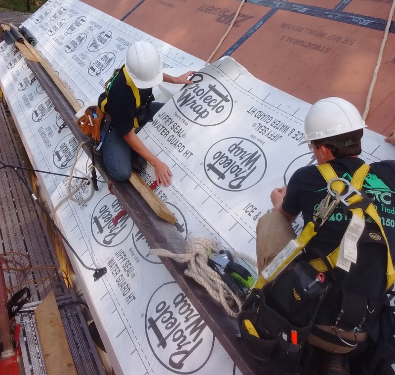

Some builders elect to use an ice-barrier membrane over an entire roof even when not required by code. There’s no question that these materials are more leak-resistant and hold up better during the construction process. Their self-sealing properties at edges and with fasteners are also a quality upgrade. Arguably, on a steep-slope roof they’re overkill and an unnecessary expense. But for some projects, they may be worth the added peace of mind.

Some ice-membrane materials fail quickly when left exposed to ultraviolet light. We’ve experienced this on large slate roof projects where it takes a month or two to get all the ice membrane covered. Hot summer days end up melting the material enough that it sticks to boots and peels into pieces. I’ve also heard of failures that weren’t as obvious, resulting in leaky structures taken apart to reveal asphalt-based sheets that have turned brittle and leaked at fasteners. This damage was attributed to exposure to the sun. We’ve learned to use higher-grade membranes rated for 180-day exposure, or even to cover the ice-barrier membrane with another layer of underlayment.
A second layer on top is also the approach we use to prevent shingles from permanently sticking to granulated-face ice barriers, which become very sticky over time. We once experienced a failure on a 2/12 slope, and it took a four-person crew about a half day per square to remove the shingles, which came off in 2- to 3-inch square pieces along with the gooey ice membrane. Savvy roofers cover this type of ice-barrier membrane with a layer of synthetic or felt underlayment. Ice-barrier membrane with a plastic top layer doesn’t have the same issue, though beware: At edges of the rolls, the sticky asphalt can adhere to shingles.

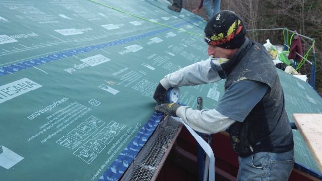

A worker seals a vapor-permeable weather barrier membrane with tape as part of an extensive roof retrofit.

In northern climate zones (north of climate zone 3), a spray-foam or rigid foam-board layer is part of most unvented assemblies, but another resource to consider is the educational material developed by 475 High Performance Building Supply. This advocates for foam-free assemblies—which use non-foam insulation layers above the roof sheathing—or even for the use of “intelligent” vapor control membranes (plus dark-colored roofing fully exposed to the sun) to manage moisture in roofs insulated with air-permeable, fibrous insulation, even in colder climates.
