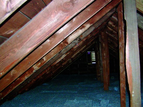

Vented, unfinished attics usually work great as built-in moisture buffers. By the word “buffer,” we mean the space that allows indoor moisture to be whisked away on air currents or to condense on the underside of the roof sheathing where it harmlessly evaporates away (“dries”) or is absorbed into the sheathing and framing before it eventually dissipates (again, “dries”). The unfinished attic makes it easy to inspect your roof from the interior.
But it’s just so tempting to take back that attic space; you can use it for mechanicals, for storage, or even as a place to banish teenagers to. We routinely configure walls without such a buffer space. So why do we run into roof moisture problems way more often than we run into wall moisture problems? To answer this first question, we need to work our way through a pretty long list of questions about attics and roofs.

1. A vented attic with gable end vents is the most forgiving type of roof. This photo (above) shows part of the author’s gabled gambrel home with a vent in each gable. Note also the gapped roof-sheathing boards, which support a slate roof. There is quite a bit of drying potential for the entire space and assembly.
photo: Peter Yost 1. A vented attic with gable end vents is the most forgiving type of roof. This photo (above) shows part of the author’s gabled gambrel home with a vent in each gable. Note also the gapped roof-sheathing boards, which support a slate roof. There is quite a bit of drying potential for the entire space and assembly.

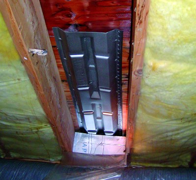

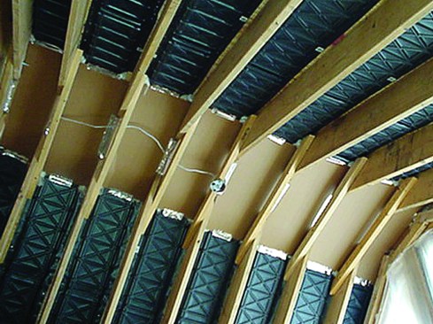

2. Vented cavity. An inexpensive option shown above is to vent a cathedralized
space using continuous vent chutes spanning the entire length from soffit inlets to ridge outlet.
photo: J&R Products 2. Vented cavity. An inexpensive option shown above is to vent a cathedralized space using continuous vent chutes spanning the entire length from soffit inlets to ridge outlet.

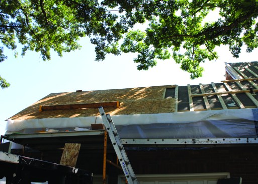

3. Top venting. This roof assembly (above) has an “over-roof”— the 2x4 furring supports nailbase sheathing for the roof cladding and creates soffit-to-ridge venting on top of the unvented roof assembly below.
photo: Steve Shirber 3. Top venting. This roof assembly (above) has an “over-roof”— the 2x4 furring supports nailbase sheathing for the roof cladding and creates soffit-to-ridge venting on top of the unvented roof assembly below.

1. Vented attic. The most moisture-forgiving attic-roof assembly is a vented attic. Properly built, a vented attic requires continuous air and thermal control layers at the top-floor ceiling with soffit-to-ridge or gable-to-gable venting.
In terms of driving forces, you gain a big advantage with soffit-to-ridge vents, or high-low venting (supported by stack effect).
2. Cavity-vented insulated pitched roof. If you can’t give up the attic space to moisture management, then the least expensive way to vent and protect the roof sheathing is to vent within the roof framing space, but that takes up valuable real estate within the cavity that could otherwise be filled with insulation.
This configuration requires continuous air and thermal control layers at the roof line with soffit-to-ridge venting within the roof framing cavities.
3. Top-vented insulated pitched roof. If you can’t give up either the attic space or the framing cavity spaces to venting, then you can add venting on top of your roof sheathing, but that comes at a significant added cost.
This configuration requires continuous air and thermal control layers at the roof line with soffit-to-ridge venting topside of the roof structural sheathing.

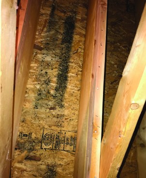

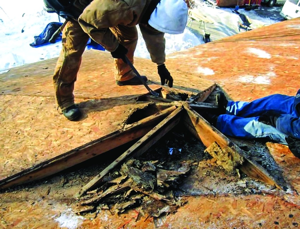

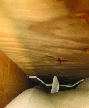

Poor air control. Each of the three photos above show vent channels that are supposed to be directing cold, dry, outside air from the soffit to the ridge, but because there is no continuous air control layer in the ceiling plane, the vents are directing leaking warm, moist air up against the cold underside of the roof sheathing.

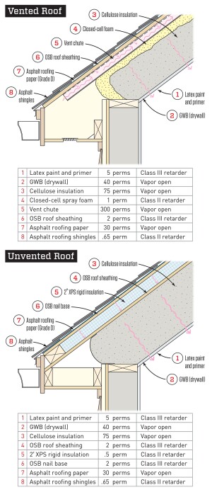

Conducting A Vapor Profile
A vapor profile is a qualitative method to determine what sort of drying potential a building assembly has, based on the vapor permeance of each layer of the assembly. There are four steps:
What's your answer? Based on your read of the vapor profile for each roof section shown above, how well  would they dry? In which direction would the vapor flow?  In Part 2 of this article, we will return to the two vapor profiles shown in these two illustrations and examine how well each roof would dry in a given direction.
illustrations: Tim Healey / Steve Baczek What's your answer? Based on your read of the vapor profile for each roof section shown above, how well would they dry? In which direction would the vapor flow? In Part 2 of this article, we will return to the two vapor profiles shown in these two illustrations and examine how well each roof would dry in a given direction.
1. Determine the vapor permeance of each component or layer of the assembly. You can determine vapor permeance by using Building Science Corporation’s Building Materials Property Table or by obtaining the information from individual product manufacturers and standardized test results for ASTM E96.
2. Assign a class to each layer, based on this information"
a. > 10 perms – vapor open: little to no restriction to drying
b. 1 – 10 perms – Class III retarder: very limited restriction to drying
c. 0.1 – 1.0 perms – Class II retarder: substantial resistance to drying but still some drying potential
d. < 0.1 perms – Class I retarder: little to no drying
3. Assess the extent and direction of prevailing vapor drive. This means taking into account the vapor drive associated with the climate, and moisture levels associated with the type of building and number of occupants. A home for a retired couple living in Hawaii in a 5,000-square-foot masonry-based home experiences very little vapor drive or pressure while a 1,200-square-foot multifamily, wood-framed dwelling unit with six occupants in Ottawa, Canada, experiences extreme vapor drive or pressure.
4. Identify the least vapor-permeable component(s) and determine if that component or those components restrict drying of moisture-sensitive components. Concern should or will be high if the restricting component is a Class I retarder and still of some concern if the restricting component is Class II.
There are a lot of variables that heighten or reduce the need for drying potential of assemblies. The goal is to determine the directional drying potential based on a vapor profile. However, having limited drying potential does not translate to assembly failure should the assembly get wet. A lot depends on how much moisture the assembly sees, how much sun it sees, and how bombproof your water and air control layers are.
