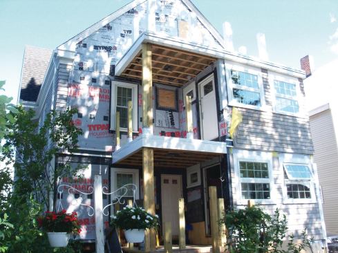

A Three-Level Porch
The project was a three-level porch on an older multifamily house just outside Boston. All three levels would have floating decks, with the TPO membrane acting as the waterproof layer beneath.
The framing was straightforward. I sloped the floor joists away from the building at 1/4 inch per foot to provide drainage, and fastened the pressure-treated 4x6 posts for the railings to the joists with bolts and steel brackets.
The structural decking is 3/4-inch AdvanTech, and according to the TPO rep, it’s acceptable to install the membrane directly over the AdvanTech. But to be on the safe side, I decided to put down an additional layer of 1/2-inch wood-fiber recover board — the same material that’s ordinarily used under rubber membrane — just in case any of the fasteners holding the AdvanTech to the joists backed out in response to lumber shrinkage or changes in temperature.
TPO roofing that isn’t ballasted in some way is ordinarily cemented to the underlayment to keep it from tearing loose in high winds. But because the porch roofs would be held down by the floating decks, I was able to eliminate that step. Fitting the membrane was just a matter of taking accurate measurements and allowing the correct amount for overlap at the seams, a turned-down strip at the fascias, and a turned-up section for flashing where the material meets the building. The membrane is fastened through to the deck with the same screws and plates used to install the recover board. The 3-inch strip of membrane that turns down at the outside edges of each deck — and the wider strips that are turned upward and flashed against the building — were adhered with double-sided Eternabond tape recommended by the TPO rep (eternabond.com).

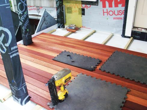

After sealing all the seams and flashing the inner edge of membrane to the wall of the house, I wrapped all the deck posts with Grace Ultra and lapped it down over the flashing boots. I then gave all three levels of the deck a water test to make sure I hadn’t missed anything.
I ran water over each of the boots with a hose, then worked my way across the floor toward the house wall while watching carefully for any drips below. I did find a small leak at the base of one boot, which was easily fixed by wiping it dry, reheating the seam, and going over it again with the roller.

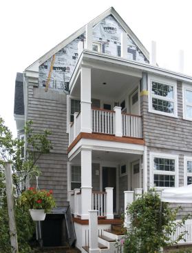

The posts themselves were later boxed in and capped with PVC trim, which prevents any water from soaking into the structure through the end grain of the posts. To further protect the TPO membrane where it’s in contact with the sleepers that support the deck boards, I placed an additional 3-inch-wide strip of material under each sleeper. These extra strips aren’t cemented or heat-sealed, but are held in place by the weight of the floating deck above.
Labor and Materials
Because this was my first time with a new material, I didn’t try to hurry the job. Working with one helper, it took me about 10 hours to install, seal, and flash the membrane on each of the three decks, not counting the time to put down the underlayment. The total cost for materials came to about $2,500, with the flashing boots accounting for almost a third of that (we used 15 4x6 boots, which cost $45 apiece, and two larger custom-made ones for the corner column at $75 each). In all, the cost was pretty comparable to what it would have cost to do the same project with black rubber roofing. Although material costs were about 20% higher, labor costs were reduced because we didn’t have to spend time spreading adhesive or standing around and waiting for it to set up.
