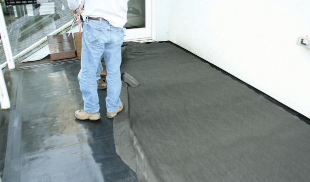

We ordered panels planted with a mix of sedum and thyme and picked them up from a distributor on Long Island. Sedum is a prolific and hardy water-storing succulent; because it’s drought-tolerant, it’s often used instead of grass on green roofs. Creeping thyme is a low-growing herb that adds a little fragrance to the garden. (We hope eventually to work primarily with plant-in-place panels that we’ve seeded in our own small greenhouse, which will allow us to vary our plantings and control the delivery schedule.)

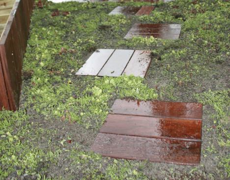

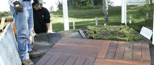

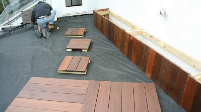

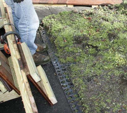

The dimpled HDPE membrane used for the base layer of these panels has considerable compressive strength (the same material is used as a drainage layer in road construction), so features like planters, paving, and decking can be placed directly on the panels after they’ve been installed. This is the typical approach on large roofs where planters and pavers occupy a small percentage of the surface area. On a small project like this one, where those features cover a large portion of the deck’s footprint, we saved material by first installing the ipe deck, stepping pads, and planters, then cutting the panels to fit using a cut-off saw with an abrasive blade. Prevegetated panels are about 95 percent planted, with the eggcrate-like reservoir layer exposed along two of the edges. When the panels are installed, their edges overlap, which locks them together. It takes only a month or two before roots completely fill in the small gaps between panels. As the plantings mature, the seams disappear — though one of the advantages of this system is that individual panels (or the entire roof) can be removed if repairs to the waterproofing layer are ever required.
