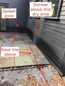

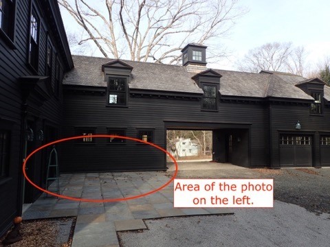

If you have good, sandy soil, and if your house is slab-on-grade construction (no crawlspace, no basement), and you have a large overhang, you can get away with no gutters. The overhang is the thing saving you. Without the overhang, you get too much splash-back against your exterior cladding.
Splash back can really ruin things, like accelerate the decay of stone, peel your paint, rot your siding, and give bugs a great, moist place to live and work. Three feet is about enough for this overhang if you don’t have gutters and seems to keep the splash-back water off the siding, but more is always better. Of course, splash back happens at upper levels also, from flat roofs or roof terraces, so those need overhangs or gutters above them in the same way that eaves above grade do. If you have a basement or crawlspace (and sandy soil), I recommend a wrap-around porch, so, that’s about a 6-foot overhang, minimum.

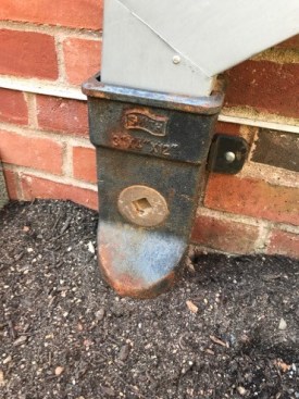

My recommendation: Keep it very low risk, install gutters, drain them away from your house, and keep the soil around and below your basement foundation walls as dry as possible. Do not pipe your downspouts into your footing drains; keep roof water entirely separate from your below-ground drainage system. Do direct or pipe your downspouts away from your foundation and don’t let them spill out onto the ground anywhere within about 6 feet of the foundation wall; farther is better. Do provide a means of preventing sticks and leaves and tennis balls from getting into your downspouts (or, at least filtering them out if they do get in). Do provide a means of easily cleaning out your downspouts if they go underground, maybe like these cool details (above).
