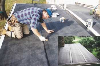

WeatherBond 110 will adhere to a variety of surfaces, including wood, metal, plastic, glass, fiberglass, rubber, masonry, smooth-surfaced built-up roofs, and nongranular roll roofing. For this reroof, I wanted to start with a good, clean substrate, so I stripped the old asphalt roofing down to the roof boards — being careful to clean and preserve the existing wall and chimney flashing — and installed a layer of 1/2-inch OSB, which I had coated with a good latex paint primer the day before installation. The primer is recommended for better adhesion of the WeatherBond butyl-adhesive backing to the wood. I primed the sheets ahead of time so that I could strip and protect the roof the same day. After checking the surface for any protruding fasteners, I cut 6-inch strips of the roofing material from the 4-foot roll and installed them over the rough edges of the plywood hip to cushion the membrane against premature wear (see Figure 1). I figured this might be one of the first areas to develop a problem.
Figure 1. Weatherbond 110 self-adhering EPDM must be installed over a clean, paint-primed substrate. The author paints OSB sheathing prior to installation in order to speed the membrane installation. To protect the membrane from wear over sharp corners, he installs a 6-inch-wide strip of the membrane over the transitions first.
The starter course is partially rolled out for alignment, overhanging the edge of the roof by about 1 1/2 inches. I made a pencil mark on the deck where the center slit in the release liner falls, marked that same measurement up from the edge at the opposite end of the roof, and snapped a guideline for the rollout. Aligning the center slit with the guideline, we rolled out the roofing, simultaneously peeling back the 20-inch-wide liner strip, leaving the 4-inch liner temporarily in place at the bottom edge. After securing the lower half of the roll to the roof, we slid the upper release liner out from the top and smoothed the wrinkles out of the membrane with a push broom (Figure 2).
Figure 2. The starter course overhangs the roof edge by about 1 1/2 inches. A push broom is the ideal tool to embed and smooth the membrane into place as the protective paper facing is peeled away.
At the overhang, we pulled off the 4-inch release strip and wrapped the membrane over the edge, nailing it to the fascia every 6 inches. I folded the outside corners over and nailed them.
