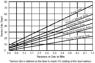

As a general rule, the thicker the zinc coating, the longer the corrosion protection afforded. As the graph shows, hot-dip galvanized fasteners will last longer than either mechanically galvanized or electroplated products.

In essence, not all zinc coatings are the same. Make sure the coating you specify is suitable for the environment in which the steel will be placed. Replacing an electroplated fastener just a few years after installation may mean spending more money than using a better quality product in the first place.
