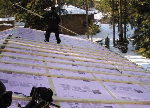

Next, we install a 2x4 nailing plate around the perimeter of the roof — a single 2x4 thickness for 1 1/2 inches of insulation and two 2x4s for 3 inches of insulation. After that we cover the area inside the nailers with 4x8 sheets of 1 1/2-inch extruded polystyrene (XPS) rigid foam, securing them to the existing roof sheathing with cap nails.
When there are two layers of insulation, we alternate the 4x8 sheets with 2x4s on the flat all the way up to the ridge. This second layer of rigid foam is fastened to the first layer with cap nails, and the horizontal 2x4 “purlins” are secured with long Torx-head screws (800/263-0463, grkfasteners.com).
After installing a double 2x4 nailer around the perimeter of the roof, the crew fills in the field with a layer of 1 1/2-inch rigid foam.
A second layer is installed over the first, with 2x4 purlins between each row to provide nailing for the spacers to follow.
The purlins provide nailing for the 2x4s that will create the vent space. Although they do interrupt the double insulation layer, we prefer to use them because it’s faster and easier to nail the spacers to purlins than to fasten them to rafters with 8- to 10-inch-long screws.
If the roof is getting only a single layer of foam, we may skip the 2x4 purlins and fasten the spacers by screwing all the way through to the rafters. At about R-5 per inch for XPS — more if we use polyisocyanurate — a 3-inch layer of rigid insulation adds R-15 to the building.

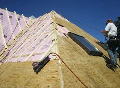

We install the 2x4 spacers 2 feet on-center, tucking the bottom ends into the vent strip and running them up the slope to the ridge on top of the insulation and edge nailers. We run the spacers long at the top, then snap a line at the ridge and cut them to length in place. If the roof has sagged, we can flatten it by shimming under the spacers.
Crew members slide long 2x4 spacers into the C-shaped perforated metal vent fastened to the bottom edge of the roof. They run the spacers long, then cut them in place at the ridge.
Sheathing. We nail the spacers to the purlins or — on roofs with a single layer of rigid foam — secure them to the rafters or decking below with screws. We then sheathe the new roof surface with 5/8-inch CDX plywood, stopping it short of the ridge so that the roof can vent to a ridge cap.
The roof sheathing is fastened to the 2x4 spacers, creating a 11/2-inch vent channel above the rigid foam insulation.
The sheathing stops short of the peak to allow airflow through the ridge vent.
