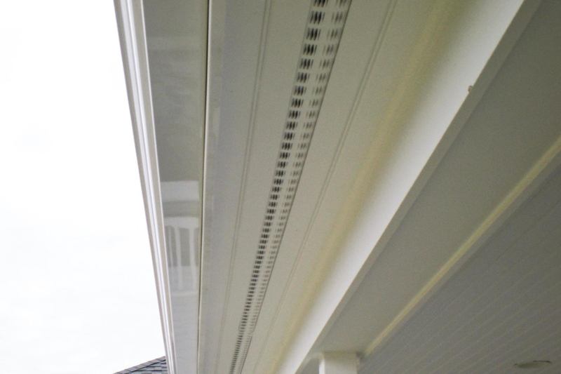

We cut saw kerfs into the edges of our soffit boards, and slip the flanges of the metal strip vents into these kerfs.

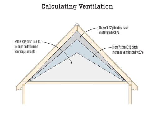

The building code doesn’t address—or ask roofing professionals to factor in—the actual volume of space under the roof. The volume for a 1,000-square-foot attic under a 12:12 pitch roof is not the same as the volume under a 5:12 pitch. Recommend practice calls for increasing the ventilation by 20% for roofs with a pitch from 7:12 to 10:12. For roofs steeper than that, we recommend increasing ventilation by 30%.

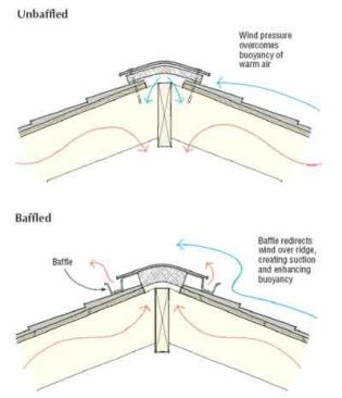

Install ridge vents that have an external baffle. As wind passes over the roof ridge, the airstream jumps over the vent’s baffle, causing suction as the air lifts upward — the same way an airplane wing works (see illustration below). Called the Bernoulli effect, this driving exhaust force works regardless of wind direction. Without an external baffle, either a single- or a double-sided roof vent can allow outside air to come in and short-circuit the venting process.

Never install a ridge vent without soffit vents. In windy conditions, a lone ridge vent could pull moist air from the house into the attic.

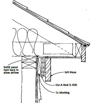

Soffit baffle. In high-wind regions where wind-driven rain and snow entering the attic may be a concern, install a soffit baffle, too, as shown in the illustration below.
In areas prone to wind-driven rain and snow, moisture can be blown into soffit vents that are at or above the level of the wall top plate. To prevent this, detail the soffit vent as shown.

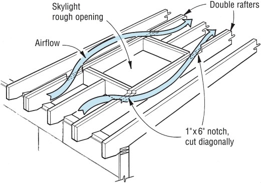

Where roof penetrations such as skylights or chimneys interrupt the airflow from soffit to ridge, cut notches or drill holes in the rafters to let air flow around the obstruction.

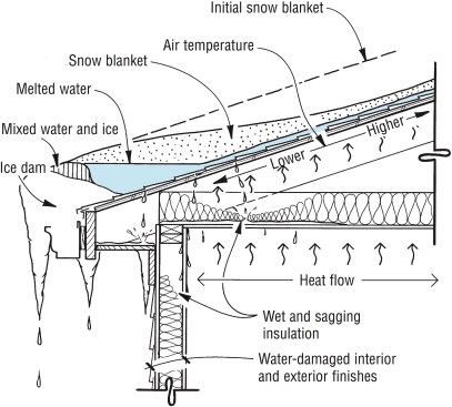

Warm air rising from the house in winter can warm the sheathing and melt snow on the roof. This snowmelt can then flow to the eaves or other cold area and refreeze, causing an ice dam. Additional snowmelt can then pond behind the dam, back up beneath the shingles.

A tight ceiling plane along with good attic insulation and ventilation will help prevent ice dams by keeping the roof sheathing cold.
Detail the eaves with a full thickness of insulation but do not allow the insulation to plug the ventilation channel near the eaves.
Keep heating ducts out of the attic space, since most heating ducts leak at the joints, and will increase attic temperatures.
