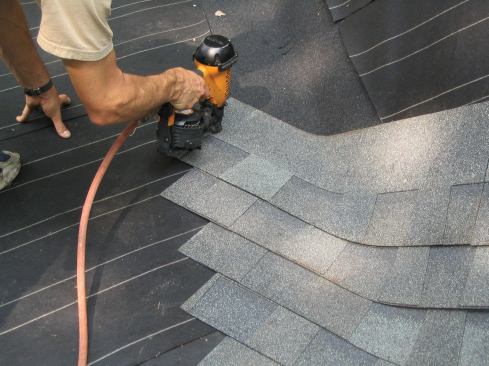

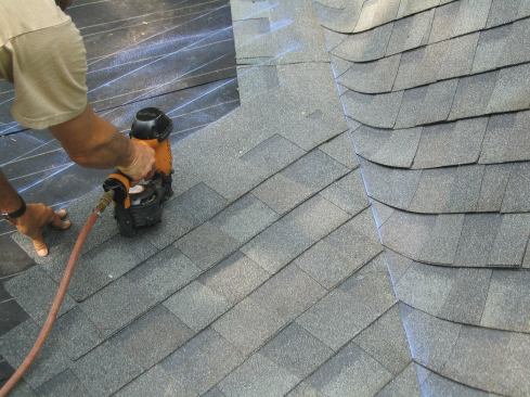

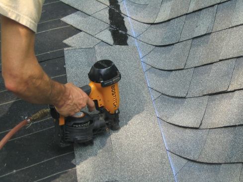

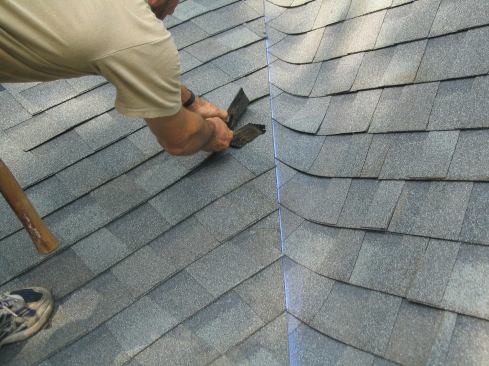

In the “Tamko” closed-cut variant (see “Tamko” valley photos), shingles from one side of the roof are laid through the valley. Then full shingles are laid end to end along a line offset 1 inch from the center of the valley. The remaining roof plane is shingled, with square-cut shingles forming a sawtooth pattern at the valley.
