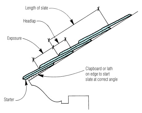

Measure Slates
To find the length required for a replacement slate, you can sometimes measure an exposed side at a gable end or valley. Another way is to multiply the exposure by 2 and add 3 in. as shown in Figure A.
To find the size of the replacement slate, multiply the exposure by 2, and add 3 in. for the headlap. Round up to 12-, 14-, or 16-in.

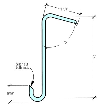

Slate Hook
Another method is to fasten a copper or stainless-steel slate hook (available from most slate suppliers) in the joint beneath the slate you’re replacing, as shown in Figure C. Drive the hook’s 3-in. shaft into the roof sheathing above the headlap of the slate below it. Then slide the new slate into place and pull it down until it rests in the bend of the hook.
In mild climates where snow and ice are not a problem, a strip of copper flashing bent to hold the slate can be used instead of a slate hook.
A slate hook is driven into the sheathing in the joint under the replacement slate. Use copper or stainless steel for a permanent replacement repair.
