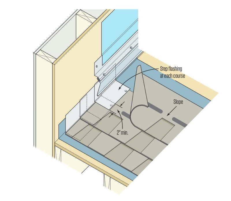

While the building code now allows you to install continuous flashing along a sloped roof-to-wall intersection, the author cautions against it and instead advises sticking with the long-accepted practice of installing step flashing, as shown in the illustration above. This detail is taken from detail ASPH-12A of the NRCA Roofing Manual: Steep-Slope Roof Systems—2013.

Step flashing has been required for asphalt shingles at roof-to-wall intersections as far back as the 1986 CABO. With this method, L-shaped pieces of metal that are a couple of inches longer than the shingle overlap are installed on top of each shingle adjacent to the sidewall, and the flashing is then laced into each course. Step flashing ensures that any water that migrates underneath a shingle will still end up on top of the flashing that is covering the shingle below. The water can then drain away safely.

To complicate matters, the new provision allowing the use of continuous flashing at sidewalls is rather vague and provides few installation details beyond the need for the vertical leg of the flashing to be at least 4 inches tall and for the flashing to divert water away from the side wall using some sort of kick-out flashing.
Installation details for continuous flashing are also missing from the asphalt-shingle manufacturers’ installation instructions. After decades of sidewall step flashing being installed beneath the shingles, continuous flashing is most likely to be installed below the shingles as well. But some installers may assume that continuous flashing should be installed above the shingles, as is done for headwall flashing. The IRC offers nothing to clarify this issue.

After all this information was discussed (with plenty of opposition) in the 2012 hearings and again in 2015, the measure was still approved. But because this new subject is not clearly spelled out in the code, I would encourage you to do a little homework before trying to change the decades-long practice of using step flashing with asphalt shingles. Review the installation instructions of the product you are installing and perhaps contact a technical representative at the manufacturer for guidance for an alternative installation method that uses continuous flashing. Then follow whatever details the manufacturer provides.
Also I’d review the adopted code, as well as any amendments, to see if your local jurisdiction has accepted this practice. But perhaps the easiest solution is to leave well enough alone and continue using the tried-and-true step-flashing method.
