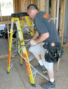

Even for seasoned electricians, bending conduit can be a challenge. Unlike plumbers, who rely on dozens of fittings to get their pipes from point A to point B, electricians have only a handful of fittings to choose from when they install conduit — and most of them are used to terminate the pipe into a box or to couple pipes. That leaves all the directional transitions for the electrician to do with his pipe bender.
The electrician uses a standard or tight-radius pipe bender to get the pipe to work around obstacles and change directions. Most benders have built-in degree scales, but knowing exactly where and how much to bend the pipe comes from experience.
Watching my electrician — who has more than 20 years of experience — bend pipe is like watching a sculptor at work. Most impressively, he uses only a few simple hand tools. In addition to the normal tools found in any toolbelt, the work requires a hacksaw, a couple of sizes of pipe benders, and a reamer.

For each run of conduit, he measures the length of travel and the distance to the nearest bend or offset; then he marks the pipe accordingly and bends it with one of the pipe benders. The whole process of getting a pipe to fit a given space follows a plan that exists only in the electrician's head; he knows exactly where to bend the pipe and to what degree, an ability that comes from experience.
Using the conduit bender as a measuring aid, the electrician marks the location of a bend.
Then he holds down the pipe with his foot and pulls the bender until the pipe is at the correct angle.
By hanging the bender from the top of the ladder, he can tweak an angle without getting down.
Benders are size specific and come in normal and tight-radius versions.
