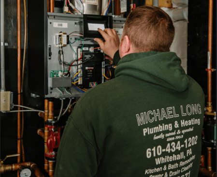

Michael Long adjusts the controls on his 155,000 Btu Aspen boiler. The unit heats water pumped through about 14,000 lineal feet of tubing throughout the 4,000-square-foot house, including a three-car garage.

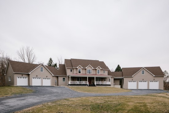

Long’s home in northeastern Pennsylvania features two three-bay garages, both heated with propane.
