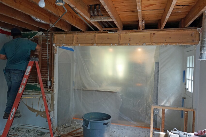

This flush beam in the second floor had no bearing on one end, only nails loaded in shear into a ledger.

The span and width of this opening requires a double-LVL beam, but in a previous renovation o open up the room to the kitchen, remodelers had only used a double 2x12.
