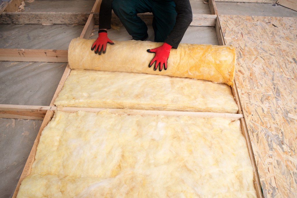

Traditional mineral wool insulation
Photo by Smole courtesy Adobe Stock

Expanded polystyrene, extruded polystyrene, and closed-cell polyurethane are petroleum derivatives that exhibit high embodied energy and include ecologically questionable ingredients, such as benzene, styrene, or chlorofluorocarbons, in their processing. Other products, like fiberglass or mineral wool batt insulation, consist primarily of nontoxic substances (glass or basalt fibers, respectively) yet still require a measurable quantity of processing, although their carbon footprint is generally lower than that of fossil fuel-based insulation.
