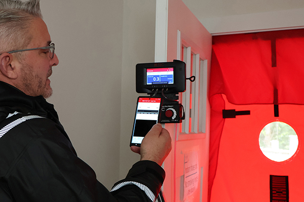

While testing a new house, the author uses the TEC Auto Test app on his smartphone to connect to his TEC DG-1000 manometer. See author’s Nov/Dec/22 story, “Upgrading to a User-Friendly Manometer” for tips on transitioning from an “old workhorse” TEC DG-700 model to a DG-1000.

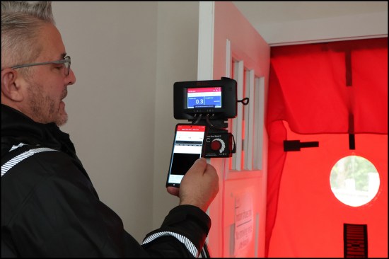

While testing a new house, the author uses the TEC Auto Test app on his smartphone to connect to his TEC DG-1000 manometer. See author’s Nov/Dec/22 story, “Upgrading to a User-Friendly Manometer,” for tips on transitioning from an “old workhorse” TEC DG-700 model to a DG-1000.

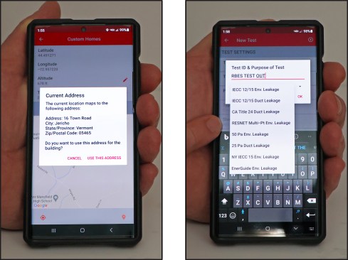

After calculating the volume of the house, I start by selecting the TEC Auto Test app on my smartphone. You can select a new project or access a list of past projects, which auto-fills the data and helps speed up the process. This is helpful because I perform blower door tests for a lot of the same construction companies. It then sends you through a series of prompts: determine location (which locates the home via Google Maps GPS); the year the building was built; the customer’s name, address, phone, and email, along with the project ID name. You then create a test.
Under test settings, the app offers a selection of eight different tests, though I prefer to use the RESNET multi-point test because of its accuracy. It takes into account a home’s altitude and indoor and outdoor temperature, and collects airflow data at different pressures, so it gives you a better average than just a single-point test (again, for RESNET, if you do a single-point test, you have to take a 10% penalty for air leakage). Enter building volume, then hit “connect” to sync to the DG-1000 (as soon as it’s connected, it shows the serial number of the manometer, so it knows which one you’re using). It’ll start monitoring, then ask for the environmental conditions, and you enter in the indoor and outdoor temperatures (the altitude of residence auto-fills from the GPS). Factoring in the altitude was new to me, which I learned about in RESNET training. You start to see a difference in the testing data at 600 feet above sea level, and many of the homes I test are above that.
It then sends you through a series of prompts: determine location (which locates the home via Google Maps GPS) (left); the year the building was built; the customer’s name, address, phone, and email, along with the project ID name. You then create a test. TEC’s Auto Test offers eight different tests (right). The author uses the RESNET multi-point test, which collects the airflow data at five different pressure points, starting with 60 pascals and going down to 48, 35, 23, and 10 pascals. Multi-point testing is more accurate for predicting building leakage at lower pressures, which are more common during normal operating conditions of a home.

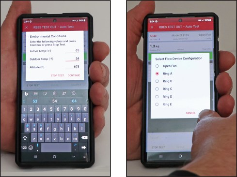

It’ll then ask to start the baseline test. After that, you enter the ring size configuration, and it starts running the fan unit. Should you need to change the ring size on the fan to obtain the measurements, it tells you to do so (you don’t have to tell the program that you changed it; the app knows automatically). The software also can detect when the equipment is not set up correctly, and it tells you so. For instance, my sons work with me because I’m teaching them how to perform blower door tests. One of them put the outdoor pressure line in line with the fan flow, and I was getting readings saying, “we can’t get the building pressure, something is wrong.” So, I checked, and sure enough, the outdoor pressure line was too close to the fan exhaust (the line needs to be at least 5 feet away). So, I moved the pressure tap and continued on with the test.
Indoor and outdoor temperatures need to be manually entered, while the home’s altitude auto-fills from the GPS (left). To start a baseline test, the ring size needs to be selected (right).

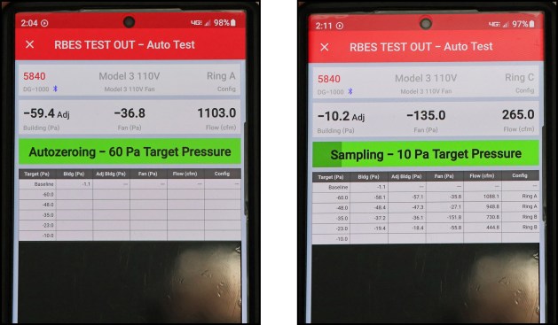

Collecting airflow data (autozeroing). The program begins the multi-point test and collects airflow data at five different pressure points, starting with 60 pascals and going down to 48, 35, 23, and 10 pascals. The app will sense if you need to change ring size mid-test, and it’ll prompt you to do so. Then once you change the ring, the app will just say “continue,” and it’ll carry on with the test. For example, on the project shown in the photos, a pop-up window, “Update Flow Device Configuration,” appeared while the program was autozeroing at 35 pascals. It noted, “Flow too small to measure for current configuration. Install ring B and press Continue or press End Test to end test at previous pressure.” My son swapped out ring A with ring B, and we continued the test.
The program will also prompt the user to change the ring size as necessary while collecting airflow data from 60 pascals (left) down to 10 pascals. A chart infills with data as the test progresses (right).

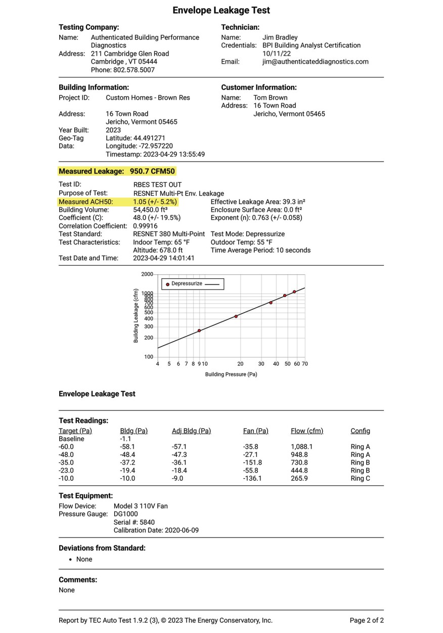

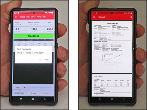

After autozeroing the 10-pascal target pressure, a pop-up window asks, “Test Complete. Would you like to review the report?” The two-page report appears instantly with all the data (temperature measurements, building volume, measured CFM50 and ACH50, etc.). It looks highly professional, and you can email it to yourself and your client in real time. As a blower door tester, I’ve found this has certainly upped my game.
After autozeroing the 10-pascal target pressure, the test and completed and a pop-up window asks if you would like to review the report (left). Selecting, “yes”, a professional-looking report appears instantly with all your data (right).

The report can be emailed as a PDF to yourself and your client in real time.
