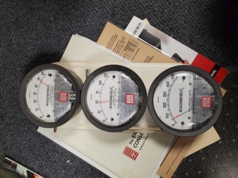

Data collection during a blower door test is most accurate if the process is automated. Blower-door manufacturers have software for quickly and precisely running a blower door test. For operating the software, smartphones, tablets, and laptops are all good choices; I use a Microsoft Surface Pro but have also used a Samsung phone and a standard laptop to perform testing. The choice of using a phone, tablet, or laptop may be limited by the pressure gauge or manometer used. The newer DG-1000 from the Energy Conservatory and the DM32 from Retrotec can communicate with a computer by a hardwire connection or wirelessly (see photos above). Some manometers may need additional components to connect to some devices. Older manometers, such as the one pictured below, are analog and require measurements to be collected manually.

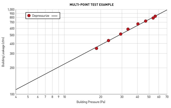

Multi-Point Test
A multi-point blower door test is conducted at several different pressure points. The ANSI/RESNET/ICC 380-2019 standard requires testing at a minimum of five different pascals of pressure between 10 pascals and 60 pascals. The airflow data is collected over a minimum of 10 seconds at each of the pressure intervals.
Manufacturers make software designed to perform these tests to the required standard; for example, The Energy Conservatory’s Auto Test software (which currently operates only on phones and tablets) has several multi-point test options. One of the options is the RESNET 380 multi-point test mentioned above. For that test, the pressure points are 60 Pa, 48 Pa, 35 Pa, 23 Pa, and 10 Pa. Another option in the software is the ASTM E779 multi-point test (another testing standard allowed by the IRC). There are eight different pressure points in this automated test: 60 Pa, 54 Pa, 48 Pa, 42 Pa, 36 Pa, 30 Pa, 24 Pa, and 18 Pa.
One reason for conducting a multi-point test is that it is more accurate for predicting building leakage at lower pressures. During normal operating conditions, a typical home rarely sees 50 pascals of pressure difference between inside and outside. More commonly, the pressure difference will be under 10 pascals. To predict the leakage rate at lower pressures, a building leakage curve is produced after a multi-point test is completed (see graph, above). Though the building leakage curve can be estimated using a single-point blower door test, the curve is more reliable when a multi-point test is used.
The test performed in the example above was an ASTM E779 multi-point test. The leakage rate at 60 pascals was 806 cfm, and at 18 pascals, 339 cfm. The curve shows us the predicted leakage rates down to a difference of 4 pascals of pressure.
What happens if you are unable to reach at least 50 pascals of pressure during multi-point testing? The 380 standard will allow a multi-point test to be used as long as at least 25 pascals of pressure can be reached. Less than 25 pascals and the test is required to be a single-point test. Most current software options will convert the test results when a “can’t reach 50” test occurs.
