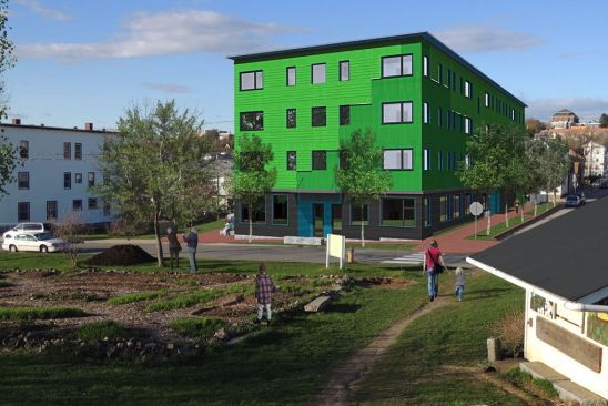

A simple form and regular detailing helped keep this 43-unit high-performance multifamily structure affordable. But cost constraints still required simplification of energy and finish details.
When it comes to budgets, the world of big buildings can be a tough environment. Architect Jesse Thompson of Kaplan Thompson Architects (KTA) told an interesting tale of cost-cutting in a session called “Huddle Together for Warmth.” KTA won a Deutsche Bank design competition with its proposal for “Bayside Anchor” (left), a public housing project in Portland, Maine. Then, successive reviews by Maine’s public housing authority forced the designers to implement two brutal rounds of cost-cutting. Heat pumps were scrapped in favor of electric resistance strip heating; exterior rigid insulation got the ax in favor of double walls with fiber insulation. But the project survived — and in fact, is still in the running to achieve Passive House certification (at least on paper).
Thompson used the project example to shed some light on the differences between the original Passive House standard created by Europe-based Passive House International (PHI) and the evolving U.S. standard authored by Passive House Institute U.S. (PHIUS). Under the old European method, the Bayside Anchor project didn’t make the cut. But under the new PHIUS rules, which measure allowable energy use based on energy use per occupant instead of per square foot, the affordable project’s high density made the difference, and the project passed.
