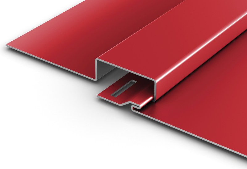

PAC-Clad Board and Batten wall panels from Petersen use concealed fasteners to maintain clean lines and a pattern of alternating wide, vertical boards and narrow, elevated battens. The 3/4-inch depth and 2-inch width of the batten keeps trim offsets to a minimum. Available in 24-gauge steel or 0.032 aluminum, panels are installed with mechanical fasteners through pre-punched holes. Maximum lengths are 30 feet for steel and 22 feet for aluminum; available widths are 12 and 16 inches. Only vertical installation is possible. pac-clad.com
