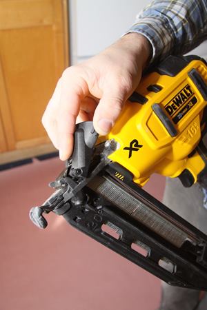

Field Tested: DeWalt DCN660 Finish Nailer
For finish carpenters Mike Triller and Bruce Cranston, the arrival of DeWalt’s newly updated 16-gauge XR finish nailer could not have come at better time. The two were just one week into a two-month-long trim job, giving them the perfect opportunity to put the gun to work.
