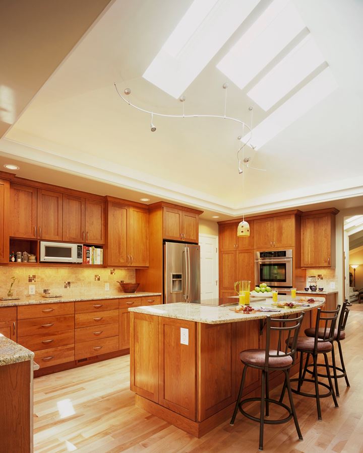

This kitchen designed by Doug Walter uses five LED lighting circuits, all on dimmers: undercabinet lighting, recessed cans, the uplit cove, track head task lighting, and decorative pendants.
Philip Wegener Photography

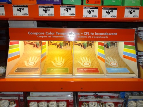

As this in-store comparison tool demonstrates, lighting' color temperature can have a big impact on a space.
courtesy of Doug Walter
What you won’t find on those shelves is a wide variety in the color of the bulbs, which is expressed in degrees Kelvin. That homey warm light so prized by many homeowners is expressed as 2700K, while the cool daylight hue of high noon comes in at 5000K. There is often little in between these two bulb hues to choose from.
That’s unfortunate, since the bright white of a 5000K bulb may be too bright—which is often the perception for bulbs on the cooler end of the spectrum—for a particular application but the 2700K bulb way too yellow. A cool white bulb with a Kelvin temperature in the 3000 to 3500 range might be just the ticket.
