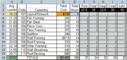

When I first started using a computer in my business, I did almost everything on a spreadsheet. Early on, the most pressing issue was to be able to estimate and feel confident that I had not made any math errors. At the time, I was using my best judgment as to how long each component would take to build, since almost everything we did was custom and I had not yet done enough job-costing to come up with square-foot or linear-foot costs for labor. So I set up a “template” with a list of labor items I used regularly to estimate labor for the job (see Figure 1).

Figure 1. The rows in this labor-estimating template correspond to specific tasks, which are coded and listed in columns B and C. Hours for each employee are entered in columns F through J. The formulas that fill columns A, D, and E (colored cells) calculate totals. I used the template as a worksheet to do my estimating and to track my labor costs once the job was underway. The layout of this template is simple. Columns B and C hold task codes and descriptions, and match those on my company’s timesheets. Each of the columns F through J correspond to one of my employees, and the headings of these columns (cells F1 through J1) hold job descriptions, such as “Foreman,” “Laborer,” or one of several skill levels of “Carpenter.” Immediately below (cells F2 through J2) is the hourly wage for each job description. The cells in the other three columns (A, D, & E) hold formulas that perform math calculations on the numbers I enter in each row; the cells in row 14 hold formulas that total the columns.

When I do a labor estimate, I follow the list of tasks, row by row, entering the number of hours I think each employee will spend on each one into the cells under each job description (columns F through J). To find the total hours estimated for a given task, column E (labeled “Total Hours”) holds a formula that adds the hours, row by row, from the job description columns. In cell E3, for example, the formula looks like this:
=SUM(F3:J3)

The SUM function works with columns of numbers, too. In my labor estimating template, for example, the formula in cell D14 looks like this:
=SUM(D3:D13)
Like the other formulas in row 14, this formula adds together all of the values in the column above it.

So far, we’ve looked at formulas that operate on cells based on their position relative to each other. For example, the SUM formula in cell E3 operates on the five cells immediately to the right (F3:J3). If we were to copy this formula into the cell just below (E4), the spreadsheet would automatically change the references from F3:J3 to F4:J4, because these cells are immediately to the right of E4. Sometimes, however, I need to use an “absolute reference” — a formula that operates on the same cell no matter where on the spreadsheet the formula is located. The formulas in column D of my template use absolute references to calculate the labor costs for each employee and add them together to get the total cost of each task. In cell D3, for instance, the formula first multiplies the number of hours in cell F3 times the hourly rate in cell F2; it does the same for each of the other four cells in the row and adds them all together. One cell down in D4, however, the formula again refers to cell F2, even though cell F2 is not located in the row directly above. If this formula used relative references, it would look like this:
=(F3*F2)+(G3*G2)+(H3*H2)+(I3*I2)+(J3*J2)
Using absolute references, it looks like this:
=(F3*$F$2)+(G3*$G$2)+(H3*$H$2)+(I3*$I$2)+(J3*$J$2)
The dollar signs indicate that the formula should reference this cell no matter where the formula is located on the spreadsheet.

You have to be careful when copying formulas that use absolute references from one cell to another. Most spreadsheets assume that all references are relative, so you have to manually go into each copied formula and add the dollar signs. An easy way to work around this problem is to give the absolute reference cells a name. In my template, for example, the cells that hold wage amounts are named “Foreman,” “Carpenter 1,” Carpenter 2,” and so on. Using these names, the formula in cell D3 looks like this:
=(F3*Foreman)+(G3*Carpenter1)+ (H3*Carpenter2)+(I3*Carpenter3)+(J3*Laborer)
When I copy it down one cell to D4, the names of the absolute references stay the same:
=(F4*Foreman)+(G4*Carpenter1)+ (H4*Carpenter2)+(I4*Carpenter3)+(J4*Laborer1)
