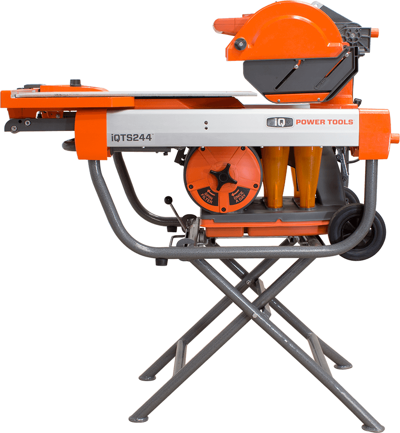

The new saw (iQTS244), which is scheduled to release this month, is completely dustless thanks to an integral vacuum that includes a multistage cyclonic filtration system and dust collection tray. It requires a specialized 10-inch blade, which is included, that cuts porcelain, marble, granite, ceramic, and stone. According to the manufacturer, the blade life is similar to what you would expect from a good-quality wet-cutting blade.
How the dust collection works
As dust is sucked through a slot beneath the cut, it is captured first by the cyclonic filtration system, which sits just below the saw’s sled, while the rest falls into the dust collection tray. After about 500 lineal feet of cutting, you spin the knob, which shakes the captured dust from the filter and dumps it onto the tray. Pull the tray out, empty it, reinstall it, and you’re ready to continue. A replacement filter runs about $90 and is expected to last up to one year with daily use. The built-in vacuum serves two functions: It cools the blade throughout the cut, and it removes debris from the kerf so the blade isn’t grinding the same material throughout.
As of right now the saw will not bevel, but the manufacturer says a bevel-cutting attachment will be available later this year. It features a 24-inch cutting capacity at 90°. A proprietary arbor that’s specially shaped holds the blade—presumably ensuring you won’t use a wet saw blade, which would deem the integral dust collection system virtually useless. These specialized blades are designed to stay cool while dry-cutting—a technology that IQ Power Tools has utilized in other masonry saws we’ve covered in the past. A replacement blade will run you $99.
The saw will sell for $1,590, which will include one blade. It’s got a 10-foot cord, two wheels, and a handle built into the cage-design of the main housing so it can be moved around like a piece of large luggage. A folding stand will sell separately for $150. It’s a hefty price tag—but the manufacturer is banking on the saw’s convenience. You can use it inside and not worry about tarps or have to deal with water, slurry, emptying, or cleaning the reservoir, or a clogged pump. For those of you who do a lot of tilework it might be worth a closer look—especially if you often work on second-floor bathrooms and have to set up your saw outside. The time you’ll save not walking up and down the stairs alone could be worth the money.
