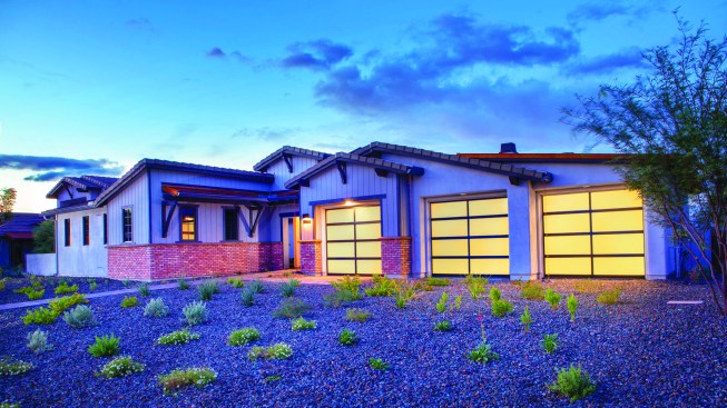

Mandalay Homes installs LED downlights over garage doors, rather than traditional carriage lights flanking the doors. This helps comply with “dark sky” regulations, creates a pleasing light, and conserves energy.

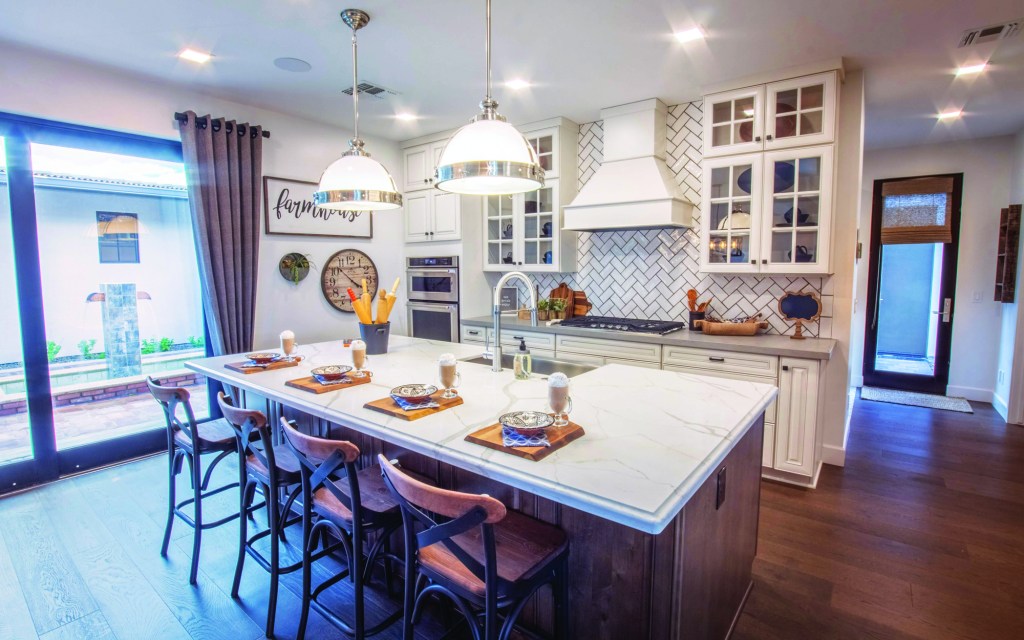

If you walked through one of the models that we are building right now as compared to a couple of years ago, you would see closer to 30 recessed can fixtures, instead of the maybe 12 or 15 in the old model. We’ve eliminated wall sconces, bar light fixtures over vanities, and fluorescent tube fixtures in the closets, laundry rooms, and garages. Instead, we have gone either to integrated-luminaire recessed fixtures or to a surface-mounted LED panel light—a much more efficient unit that puts out really great light. For recessed downlights, we spec Parmida dimmable retrofit fixtures and Nicor 4-inch Surefit LED fixtures.
So how has this change affected our costs? Compared with a recessed can with a screw-in bulb, the recessed integrated luminaires we’ve chosen cost the same. But it does cost us about $7 or $8 more per location to install one of these integrated luminaires than it would cost to do a wall sconce or a bathroom bar fixture. That cost differential varies case by case. In some places, we lose a little bit of money, and in other places, we make a little bit.

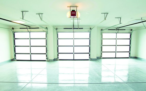

Inside the garages, Mandalay Homes has transitioned away from conventional 40-watt fluorescent tube overhead lights in favor of LED panel lights; the up-charge for those fixtures is mostly offset by their greater light output and improved light quality. An internet-controllable garage door opener from LiftMaster is also standard in the garage.
Andrew Decarlo Inside the garages, Mandalay Homes has transitioned away from conventional 40-watt fluorescent tube overhead lights in favor of LED panel lights; the up-charge for those fixtures is mostly offset by their greater light output and improved light quality. An internet-controllable garage door opener from LiftMaster is also standard in the garage.
Transitioning from fluorescent tube fixtures over to LED panels in the garage did cost a bit more: The LED fixtures cost about three times as much per fixture. But whereas we used to put two fluorescent fixtures per garage bay, now we are installing only one of the LED panel fixtures, because they put out so much more light per fixture then the fluorescent did. So when you do the math (including labor), it’s only about a 20% cost increase to provide that better light.

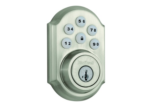

Mandalay Homes’ basic home package includes internet-capable amenities such as a programmable Kwikset SmartCode door lock.
Henry Hamamoto Mandalay Homes’ basic home package includes internet-capable amenities such as a programmable Kwikset SmartCode door lock.

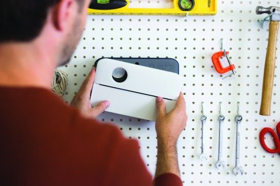

Also included is a smartphone-controlled Rachio landscape irrigation timer.
Pavel Fedorov Also included is a smartphone-controlled Rachio landscape irrigation timer.

  • an internet-connected SmartCode 910 programmable door lock from Kwikset, controllable using Kwikset’s SmartCode smartphone app

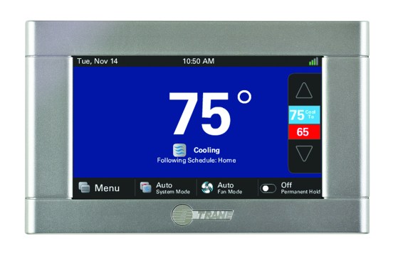

  • a programmable Trane thermostat, the ComfortLink II XL850, capable of being remote-controlled with a smartphone through Trane’s home automation system, Nexia
  • a Generation 3 connected programmable landscape irrigation controller from Rachio

Mandalay Homes’ basic workforce housing includes a programmable, internet-capable thermostat supplied by Trane.
Michael LoBiondo Mandalay Homes’ basic workforce housing includes a programmable, internet-capable thermostat supplied by Trane.

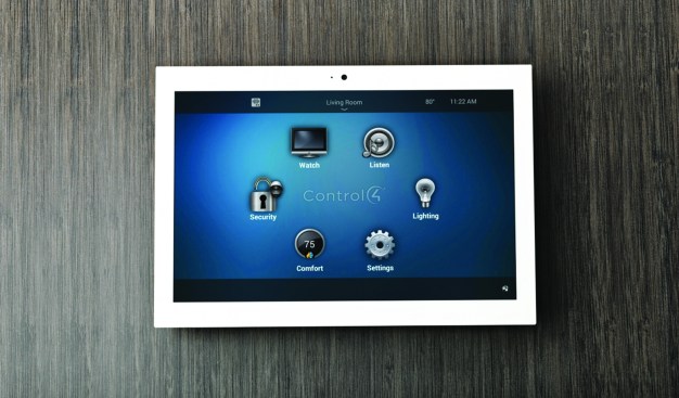

But in most houses, a Control4 home automation interface takes over the job of the thermostat. This Control4 panel also manages lighting, audio, video, and more.

So our basic, entry-level house package has a lot of controllable elements. Most of our homes, however, also come with a Control4 controller installed as a standard feature. That way, the customers don’t have to bite the $1,000 bullet on the controller itself; when they come to the design center in the model home to make selections for their own house, they’re just looking at all the cool things the controller can do. We’ve already made the investment in the controller for them.
Here’s how it works: As part of the 60-day design process before we break ground on a new home, the buyers will have an appointment at our design studio where they can pick out the pretty stuff, like tile, countertops, flooring, and so on. While the buyers are at the studio, they also meet with our electrician representative and can talk about high-voltage upgrades, such as a spa circuit or an additional 220-volt outlet in the garage, in case they have some kind of hobby that requires one.
As part of that same appointment, the buyers also meet with a salesperson who specializes in low-voltage devices. That’s when they get to choose from a suite of cool gizmos that the Control4 system can integrate: landscape fountain lights, security cameras, remote controls, distributed audio and video, and so forth. Because we’ve already made the investment in the controller, they don’t have to get over that hurdle.
The controller lets us manage things that we don’t even need the homeowner to be aware of. For example, we set the dimming controls on the LED lighting so that when the fixture is turned on, it ramps up to only 80% power. Studies have shown that the human eye can’t tell the difference between 80% and 100%, but the lower setting saves energy and extends the service life of the fixtures.
