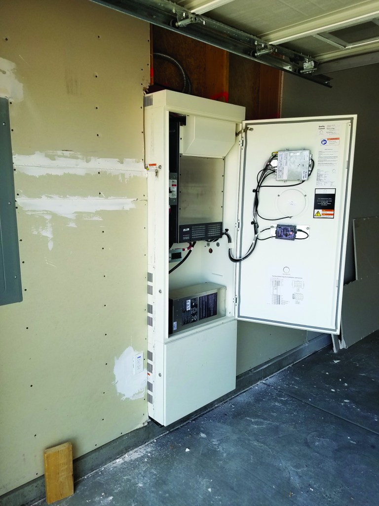

The secret is in the home’s Sonnen battery compartment; here, power stored up on sunny mornings will supply the house all afternoon.

One production builder in Arizona has come up with a workaround that looks like a win for all sides, including builders, homeowners, power companies—and the environment. Prescott, Ariz., builder Mandalay Homes, in partnership with German battery supplier Sonnen, has broken ground on Mountain View, a 323-home development where each house will have a solar array on the roof and a power-storage battery bank in the garage. And rather than be either a threat or a burden to the local utilities, the community’s “solar plus storage” setup will help the power company solve its own difficulties with managing Arizona’s sharp daily swings in energy supply and demand.
The homes in Mountain View will generate about 80% of the power they need, on an annual basis, says Mandalay chief technology officer Geoff Ferrell, and they will qualify for a federal tax credit to offset part of the cost of the solar and battery investment. But unlike solar-equipped homes that don’t have batteries, these battery-equipped homes won’t pump excess power production into the grid during sunny periods when the roof is making electricity, but nobody is home to use it—times when the utility already has more electricity than it can easily handle. Instead, each home’s panels will charge up its own batteries every day, using the home’s own extra solar power. Later in the day, when the utility is struggling to meet its daily peak service demand, the house will stop pulling power from the grid and instead supply its needs from the battery bank. Rather than being part of the problem, these solar-powered houses will be part of the solution.
In return, Arizona Public Service (APS) has agreed to give homeowners a reduced electric rate—as long as the house keeps its side of the bargain by “going dark” (from the utility’s point of view) from 3 to 8 p.m., the crucial peak-demand period. That reduced rate more than pays for the cost to finance the solar-plus-battery system that makes the whole strategy work.

That’s without any site energy or battery storage. Then Mandalay takes it a step further. “First we look at the energy load,” said Ferrell. “How much power is that home going to use on the hottest day in summer, or on the coldest day in winter? And we have some pretty good equations for that.” Next, the company installs a solar array to supply 80% of that peak load. “We do still pull some energy from the grid,” said Ferrell. “It’s about 5 or 6 kWh on any given day. But we pull that energy when the utility wants us to—in the middle of the night, or a little bit in the morning. Then when the sun comes up, the solar panels start collecting, and when we’re collecting enough solar power to run the house, any excess solar power begins charging the battery.”
Sonnen software controls the system: “The software looks at the battery and says, ‘I need to get back to 100% charged by 3 p.m. Am I getting enough power from the solar panels?’ And if not, it starts to trickle-charge off the grid as well. Which is good for the grid, because that’s when the grid already has a ton of energy and they’re looking for places for it to go.”
“We have 15 different floor plans in Mountain View that go from 1,400 square feet up to about 3,000,” said Ferrell. “They offer between three and four bedrooms standard, but some plans have options that allow them to go up to five and six bedrooms.” The solar arrays are relatively modest, Ferrell said: six panels on the smallest homes, and eight for the larger models. But the battery packs are larger: All the homes, even the smallest ones, get a 10-kWh battery pack—”which is more than any of them need,” Ferrell said. “But I need that much battery power to match the 8-kW inverter that we put in every house. And we need that powerful inverter because between 3 p.m. and 8 p.m., I have to ensure that we do not use grid power, no matter what. So I need that power at my disposal for an oven turning on, or the washing machine starting up, or whatever—so that I can handle those peak loads.”
