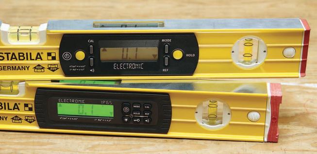

Regardless, when I recently tried a Stabila Type 196E Tech box-beam electronic spirit level while building a fence and two decks, I discovered that the electronics can be a blessing, especially when working solo. Stabila is now replacing that level, which debuted in 2006, with the new IP65 Tech. After evaluating the new model, I think it offers the same benefits as its predecessor, plus some noteworthy upgrades.
The Digital Advantage

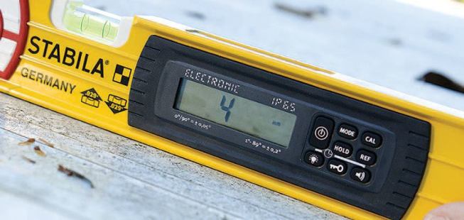

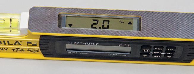

The new IP65 Tech is, above all, a first-rate spirit level. According to Stabila, the plumb and level vials are accurate to within .029 degrees in any working position, which matches the accuracy of the company’s conventional Type 196 box-beam spirit level. Press the IP65’s power button, though, and digital displays on the front and top clearly indicate level and plumb (using arrows to help guide you there quickly) or read slopes in your choice of degrees (in .05 or .1 increments), percent (in .1 increments), millimeters per meter, or inches per foot (in .01 or 1/8 increments). The displays deliver a measurement within about a second after the level comes to rest. Flip the level over and the front display flips right-side up. Not only can you quickly check a roof pitch or determine the slope of a drainpipe, gutter, or patio, but you can easily establish running and cross slopes that meet ADA standards for accessible design.

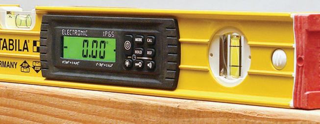

I find that feature useful even if it helps me only occasionally, like the LED headlight on my cordless drill. But what I really like is that instead of being forced to look directly at a vial, you can view the dual display off-center, which can make even basic leveling and plumbing much easier. In cases where that doesn’t help, you can press an audio button to make the level beep progressively faster and then emit a steady tone as it approaches and then hits level or plumb. Go too far and the beeps return with a different pitch so you know which direction to move the level. That’s all good for solo carpentry tasks like plumbing fence posts while nailing braces to them, using long horizontal 2-bys with the level on top for transferring layout marks, and shimming cabinets, not to mention leveling a pool table.

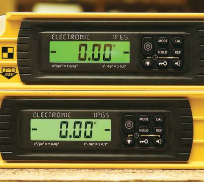

The display’s tidy dashboard includes several other useful buttons. The “HOLD” button freezes a measurement, which can be handy when you need to check a slope but can’t easily view the display, or when you need to transfer an angle to a saw. The “REF” (or alternate-zero) button sets any angle or slope to zero, which simplifies repetitive work and allows you to use the audio signal to pinpoint the referenced angle or slope. A button with a key-shaped icon on it locks the REF and measurement settings and retains an alternate-zero setting even when the display is turned off. Another button turns on a backlight, which makes the display much easier to read in dim light; you can chose a bright backlight that shuts off in a minute or a softer, more energy-efficient one that isn’t on a timer. The display itself can be set to shut off after idling for either 7 1/2 minutes or two hours.

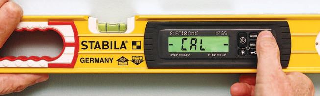

The display should be recalibrated regularly – especially if you drop the level or use it in widely fluctuating temperatures – and the IP65 Tech makes this easy to do. You just hold the tool against a vertical surface such as a wall or a window, use the level vial to level it exactly, press the “CAL” button twice, wait a few seconds for “rdY” to appear on the screen, and you’re good to go. Or, for optimal digital accuracy in all working positions, you can do a four-point advanced calibration instead that still uses a vertical surface and takes about a minute rather than the usual 10 seconds.
