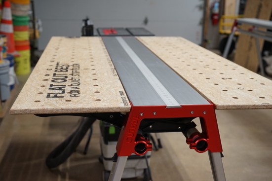

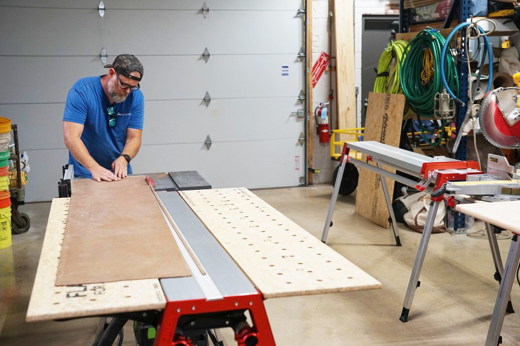

The table saw setup is great. There aren’t a whole lot of other systems out there to compare it with. With the side supports, the outfeed table is large yet surprisingly light. With its adjustable legs and simple, sturdy connections, it is extremely easy to set up, move around the site, break down, and transport. The outfeed table proved exceptional for cutting long and large material, allowing one individual to rip a full sheet of plywood easily and safely.
Initially, I was concerned by the size of the mounting kit for the table saw, as it seemed too small for our SawStop Jobsite Saw. But we weren’t confined to using the Cut Hub table-saw mounting kit; we could remove this part from the outfeed table and use the SawStop with its own stand. Because the Cut Hub legs are adjustable, it proved easy to raise the outfeed table to match our table saw’s height. (The tables adjust from 32 to 38 inches in height.) I have also used the Cut Hub as an outfeed table for my planer.

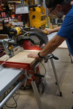

The miter saw setup is big and sturdy but very light (each section weighs about 40 pounds). Just like the table saw unit, the breakdown and setups are quick, and the entire assembly is light enough that moving it around the site isn’t an issue.
Cut Hub easily has the most robust sliding stop out there for making repetitive cuts. The operation is smooth, and it locks down with no chance of slipping. We used this to great effect on a job where we were fabricating site-built trusses and making a lot of repeat cuts at specific angles.
I think the Cut Hub really shines for increasing the productivity of non-skilled employees. Most of the laborers who work with us and don’t have deep experience with cutting tools are more comfortable using a miter saw than a circular saw, for instance. Having solid support for long material and plenty of real estate on the side tables makes a miter saw that much friendlier and safer to use and helps shorten a new carpenter’s learning curve. If needed, the stop can be set up by a more experienced worker and the workstation turned over to a novice, say, to reliably cut stud lengths with precision.
One initial cause for concern was we had more play than we wanted between the miter saw table holding our 12-inch DeWalt sliding saw and the support wings. For the price on this tool, I didn’t expect that kind of play at all. I suspect it wouldn’t have been an issue with a lighter saw. I was able to shorten the span between the wings and my saw by ignoring the detents and tightening the cam locks that hold the wings in place. This helped reduce the movement. The only negative to this solution was that by ignoring the detents, you end up throwing the measurements on the built-in tape off. This isn’t a big deal as we are inclined to check measurement with our own tapes anyway when precision is a must, but it is a small hitch that we have to keep in mind.
