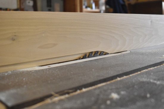

To avoid warping, I like to glue up a sandwich of 3/4-inch boards, face to face, for the door-frame material. First, I rip the boards 3/8 to 1/2 inch thicker than the finished dimension. Before I coat the faces with Titebond glue, I make sure they’re clean and smooth by using very light passes with a planer. I use pipe clamps to make a glue-up wide enough for a stile or rail. By leaving a dry joint between the stile or rail pieces, I can glue up several pieces at one time. I make the glue-up 4 or 5 inches longer than the finished length so I can trim any planer snipe off the ends. To achieve a good bond, it is critical to glue your parts up on a clean, flat surface. After a couple of hours, I unclamp the boards and scrape off most of the glue that has squeezed out.

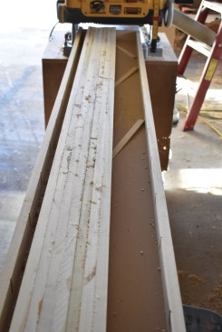

The next step is to get a flat face on one side of the glue-up. A large jointer is the easiest way to do this, but if you don’t have one, you can make a rigid sled and run the pieces through a planer. Place shims under the glue-up to keep it from rocking. On the door shown here, the stiles, top rail, and intermediate rails were 4½ inches wide and the bottom rail, 8 inches wide.

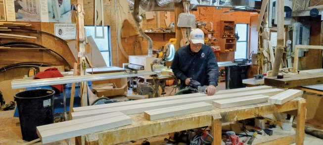

When all the frame pieces have a flat face, I run them through the planer to final thickness. For this door, I used ¼-inch-thick maple plywood for the face veneer, so the final thickness of my frame parts was 2¼ inches minus the thickness of two pieces of plywood.

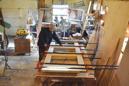

To allow room for final adjustments to fit the door to the jamb exactly, it’s a good idea to build the door slightly oversized. Here I cut the stiles ¼ inch long and cut the rails an extra 3/8 inch wide. Besides the top and bottom rail, I added two intermediate rails for strength. My plan was to fill in the voids with rigid foam sheets.

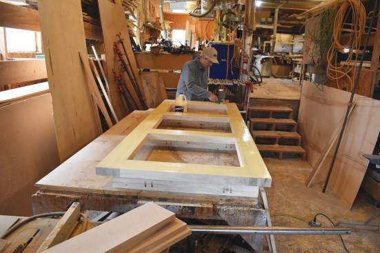

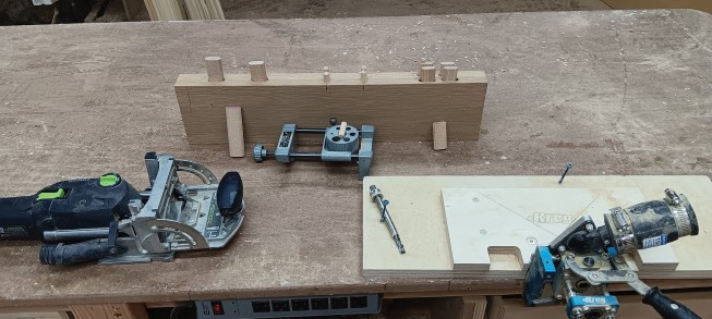

I have a 4-by-8-foot table in my shop with a dead-level top (I used shims and an 8-foot level) that I use to assemble doors and cabinets. For the top and middle joints, I used two 12mm Dominoes; at the bottom rail, I used three. If you don’t have a Domino XL, two rows of smaller Dominoes or even dowels will work.

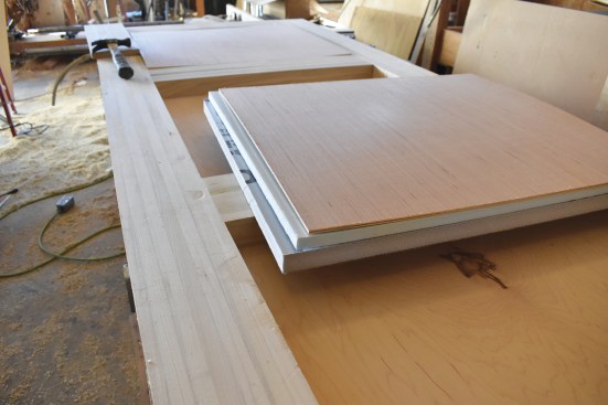

While the glued-up frame was drying, I laid out and cut the plywood veneers to size and added the vertical lines (⅛-inch-deep saw kerfs on 3-inch centers) using a track saw. The joints in the frame needed a little sanding, and I was ready to glue on the veneer. I added spacer blocks to my table to make room for clamps.
This door was well under a porch roof (if a client asks me to build a door that’s not under 4 feet or more of roof, I have them respond to an email that states I do not guarantee the door), but I still used Type-2 Titebond for water resistance. I use a glue roller with a hopper to spread glue for projects like this. For a good glue joint, I use a K-body clamp every 3 inches around the frame, plus a board with wedges at the rails. If you don’t have that many clamps, place your door glue-up between two sheets of MDF and put bags of cement, sand, or even concrete blocks on top to create pressure.

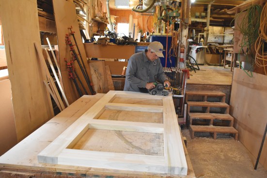

After an hour, I removed the clamps, fit foam and a plywood shim in the voids, and clamped the second veneer (9, 10). An hour is probably enough drying time but, to be safe, I let it dry overnight, then used a hand-held planer to bevel the door edges.

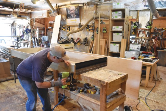

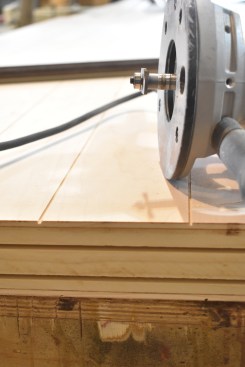

I make the door jamb in two pieces. The first is ¾ inch thick, and its width is equal to the wall thickness. For better access, I like to mortise for the hinges before I assemble the jamb. For a door this size, four 4½-by-4½‑inch hinges work well. I make a plywood template and use a ½-inch Whiteside template bit (part number 3000) to cut out recesses for the hinges. The ½-inch bit leaves ¼-inch round corners that must be squared out.
I use the same plywood template to mortise for the hinges in the door. To allow room for a reveal across the top of the door, I attach a ⅛-inch-thick spacer on the template to hook on the edge of the door. Though this door wasn’t a standard size, I started with measurements from a standard door and adjusted them to the size of my door.

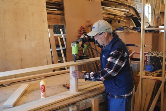

The second part of the jamb is ½-inch-thick maple with a saw kerf on the back edge to seat the weather-strip fin. To find the width of this second piece, I measured the setback on a standard door jamb and adjusted for the thicker door. To start building the jamb, I stapled the ¾-inch maple header and the threshold between the side jamb material. I used glue and headless pins to add the ½-inch-thick maple.

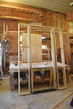

Sidelights

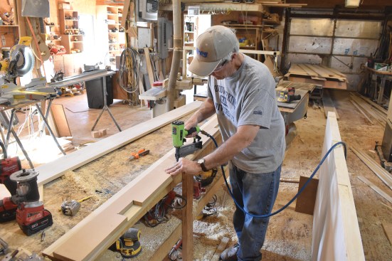

I started to build the sidelights by gluing two pieces of ¾-inch maple together. I used this thick material to make a wood threshold with a rabbeted edge and four crosspieces with rabbeted edges for the muntins. I stapled the head jamb and the wooden threshold between the side jambs, then added ½-inch-thick material up to the location of the first muntin, which was also stapled in place. I added a piece of ½-inch material on each side up to the second muntin location, stapled it in place, and filled in to the top with ½-inch material. The rabbeted edges were all ½ inch to hide the spacers between the insulated glass panes. I made some ½-inch glass stop with a chamfered edge to be installed after the glass was in place.
