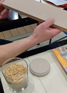

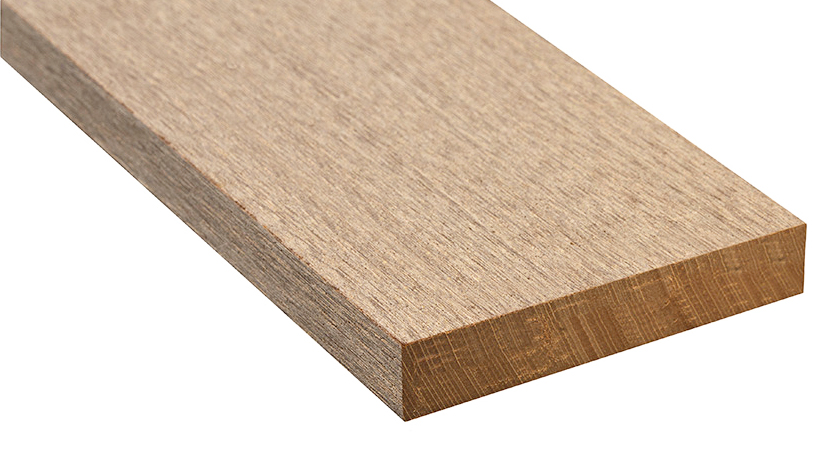

Acre – a trim, siding, decking, and panel material made by Modern Mill -competes with cellular PVC in the exterior trim market, composites in the decking and siding markets and MDF in the cabinet market. It is way more convincing as a wood product … but has no wood content at all. The bulk of the material by volume is rice hulls, making for a sustainable, ground-contact, water-impervious wood alternative.
Acre board trim made from rice hulls. (A sample of the hulls is in the glass in foreground.)
Rice is produced in six U.S. states, so there is a huge, quickly regenerating supply of hulls as a waste product with a lot of intrinsic value as a building product. As Chandler Delinks of Modern Mill explained, the hull is an inedible organic material that surrounds the edible kernel, protecting it from water and mold when the plants are fully submerged in water. As the plant matures, the hull also protects the kernel from UV-light. What’s especially convincing to me is how this material works like wood. The sawdust is not static-charged like you get from cellular PVC. Though there is PVC mixed with the rice hulls, the dust is more granular, and falls to the ground. And maybe best of all, the material cuts and mills with ordinary woodworking tools, leaving a consistent edge. The samples I saw showed no open cells in the core, so you can rip it, plane or sand the saw marks away, knock down the corners, and you have a finished edge just like you get with wood.
It’s fairly light to carry, won’t snap under its own weight, and you won’t need to keep a separate set of tooling like with TruExterior (a.k.a. poly-ash, formerly known as Boral). Acre reportedly doesn’t expand or contract as much as PVC materials, so long runs don’t need to be gapped quite as much. It comes in 4’x8’ to 20’ panels in ¼” to 1” thicknesses (a nice alternative to MDF that actually will holds a screw on all surfaces, including edges); 5/8-, 3/4- and 1-inch (actual) board thicknesses in 3,4,5,6,8,10,12,16 (nominal) widths in 8’ and 20’ lengths; and 5/4×6 decking boards (with siding profiles coming soon). Reportedly, the price of trim boards is comparable to cellular PVC.

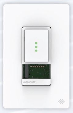

Panasonic has teamed up with smart control company, Swidget, to develop a series of controls that can be plugged into a port within a wall switch or outlet. A variety of wall switches, dimmers, and outlets are available. This one is a timer switch with three settings for 20-, 40-, and 60-minutes to control a bath fan. A sensor module can be plugged in to also turn on the fan based on (for example)  humidity, temperature or motion.
In the debate over ventilation rates, perhaps the smartest solution is to modulate fan speeds and ventilation rates relative to the actual pollutants in a home. That approach requires ventilation controls that can actually sense indoor air quality, and that seems more and more possible.
Panasonic has teamed up with Swidget, a control company that is producing a line of inserts with different functions that plug into specialty wall switches and outlets. So, for example, there are inserts for a night light, USB charger, and such that extend the functionality of the switch or outlet. But there are also control sensors – a motion detector; motion, temperature and humidity sensor; and an air quality sensor, among others (see image below). These sensors, along with the manually operated wall switch, are intended to control the Panasonic line of ventilation products.

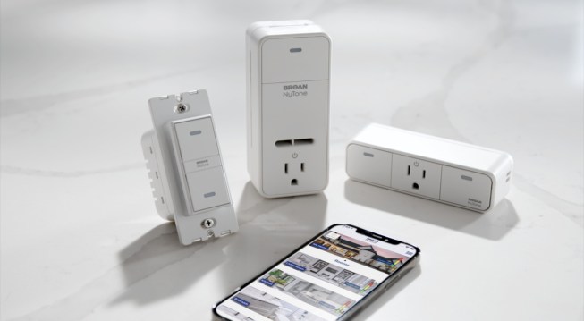

The Broan-NuTone Overture controls, which sense humidity, VOCs, smoke, carbon dioxide and PM2.5, are larger, and plug in externally to an outlet (see the center and right plug-in sensors in photo below).
A selection of sensors in the Broan-NuTone Overature family. When the sensors detect a rise in indoor air concentrations of humidity, VOCs, smoke, carbon dioxide or nano-scale particles known as PM2.5 they switch on ventilation fans.
Broan-NuTone gave a sneak peak of the Overture control system at the last in-person IBS in 2020, and launched it between shows. The complete system, which combines sensors, switches and connected plugs to control bath and whole-house fans, range hoods, and ERVs to exhaust polluted air and (in the case of the ERV) introduce fresh, filtered air.
Both the Broan and Panasonic systems can be managed with a smart-phone app, allowing users to monitor a home (or individual rooms) and record historical data.

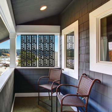

Barrette Outdoor Living introduced a series of decorative panels. Available in two sizes—2- x 4- and 3- x 6-feet—the aluminum panels can be installed a privacy screens (as shown here), integrated into the company's deck railing, or used as below-deck "lattice."
Barette Outdoor Living is a fairly new name in the deck/outdoor living market, but the company has been around for years, selling railing (under the RDI name) and various types of composite decking. It has rebranded and smartly consolidated its offerings under a unified concept trademarked “The Outside Company.” Debuting the fresh company at IBS, Barette Outdoor Living introduced a number of intriguing deck products, including an “outdoor flooring system” dubbed InstaDeck. For me, the best offering is the company’s line of decorative panels that can be integrated into its railings and as outdoor privacy screens.
Selection of Barrette Outdoor Living’s decorative screen panels
The polypropylene panels, which come in two sizes—2- x 4- and 3- x 6-feet—can be integrated into the company’s deck railing or it’s aluminum pergola. But they can also be built into the side of a porch (photo above) or (what I like best of all) used to screen the base of a deck in lieu of lattice.

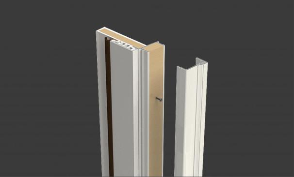

Endura, which is known for making smart door components like a replaceable metal threshold and rot-resistant jambs, has introduced a fully featured door frame that is designed to provide optimal resistance to the elements but also make installation easier and less dependent on the condition of the wall.
Endura's Fusion Frame is a customizable composite and wood door jamb with removable stop and brickmold covers, and adjustable brickmold that simplifies installation.
In new construction and old, exterior walls are often not plumb nor very flat, which has caused many a carpenter plenty of grief for time immemorial. It’s tough with standard pre-hung units that come with the brickmold attached, as it requires installers to do all sorts of tricks to get opposing shims in the right place and at the right thickness. The Endura Fusion Frame comes with an adjustable brickmold. In the photo above, we see the snap-on cover for the brickmold, but the whole brickmold itself comes off so you can set the jamb plumb, shim the frame from both sides, and then fit the brickmold in place, regardless of the wall condition. The frame itself has an engineered wood core that is reportedly not as prone to thermal changes as a composite frame. This gets covered by removable jamb and brick mold covers that hide the fasteners, making for a clean install all the way around.
Endura does not make doors, but specializes in the components that go into door units. The products can be ordered through BetterDoor.com, but are most often available from door companies that use the components.
