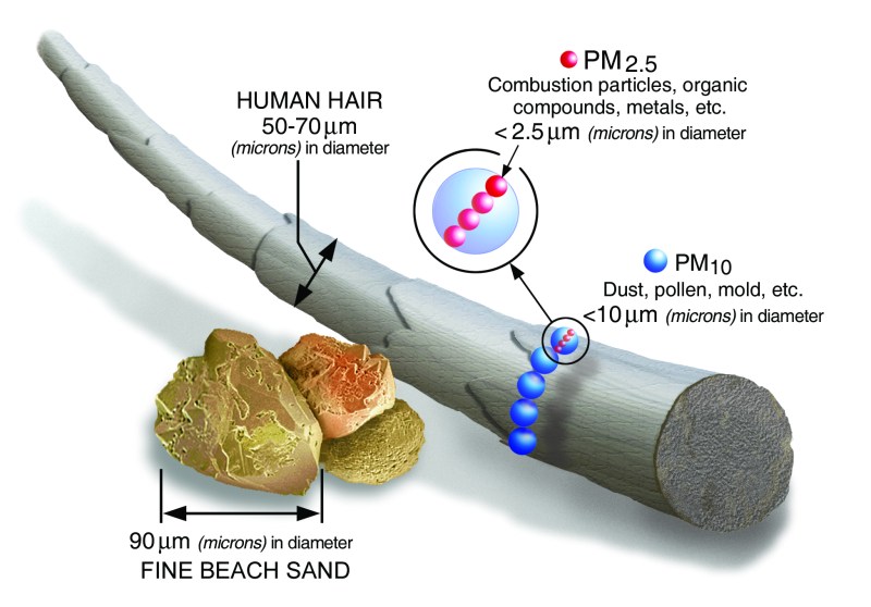

Size comparisons for particulate matter, or PM. Particle pollution includes:PM10 : inhalable particles, with diameters that are generally 10 micrometers and smaller; andPM2.5 : fine inhalable particles, with diameters that are generally 2.5 micrometers and smaller.How small is 2.5 micrometers? Think about a single hair from your head. The average human hair is about 70 micrometers in diameter – making it 30 times larger than the largest fine particle. (EPA)

As buildings get tighter, do we risk higher concentrations of indoor air pollutants? That’s certainly been the conventional wisdom for a long time. And it’s apparently still true for things like radon and VOCs and formaldehyde. Only it turns out these are not always the most prevalent indoor pollutants. Pollutants from outdoors may be the biggest IAQ problem we face.
In a recent pair of blog posts, Allison Bailes has taken on the topic of indoor air pollution in an important way. If you only have time to read one of these posts, read: Which Pollutants Matter Most? in which he picks up on research by Brett Singer of the Lawrence Berkeley National Lab presented at Building Science Summer Camp last August. Singer showed that while most people think about formaldehyde and other VOCs when the term IAQ is brought up, the most common pollutants are incredibly small particulates dubbed PM2.5. These particles are so small that they often are breathed deep into our lungs and often go straight into the bloodstream.
Smoking indoors, burning candles and cooking produces a lot, but most PM2.5 comes from outdoor sources. The exhaust from cars and trucks is one of the most prevalent sources in most areas.
Allison lists the indoor pollutants we should pay attention to, and gives us a succinct description of what we can do about each one to improve indoor air quality. Source control is often the most effective solution, but for the most prevalent pollutants in the PM2.5 range, Allison points to point-source ventilation (kitchen hoods and bath fans to remove particulates) and filtration as effective control strategies.
That brings us to the second of Allison’s blogs, 7 Reasons Your Filter Isn’t Improving Your Indoor Air Quality. Anyone who has anything to do with installing mechanical ventilation and forced air heating systems should be aware of the issues raised in this blog. It’s not just a matter of changing the filter, or choosing a high MERV filter, although that helps. (You need at least a MERV 10 filter to begin getting at least half of the PM2.5 and MERV 13 to filter out a significant portion of the tiny stuff.) Take note, here, that a high-MERV filter may reduce airflow if your system was not designed for it. Allison intends to dive deep into this in the next few blogs.
While filtration is one way to limit exposure of PM2.5, source control still plays a strong role. Given that most PM2.5 comes from outdoors, air sealing is the control strategy for limiting the source. Brett Singer, in his presentation at Building Science Summer Camp, demonstrated how the “penetration factor” – the fraction of outdoor particles coming into a home with infiltrating air – gets lower the tighter a house becomes.
