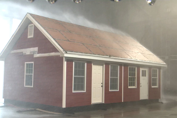

A test house in the IBHS Research Center faces 105-mph wind and torrential rain as Huber Zip System roof sheathing holds water out.

But you’ve probably never had a house under construction go through a hurricane, and you may have wondered whether that roof sheathing by itself would keep the house dry during 105-mph winds and blinding sheets of rain, in case the shingles were lost. Well, I’m here to tell you that it would. That’s what I saw in a recent trip to the Insurance Institute for Building & Home Safety’s Research Center down in Chester County, South Carolina.
The Research Center’s wind tunnel facility is a one-of-a-kind laboratory. It’s big enough to hold an entire house and powerful enough to put that house to the test: A bank of 105 fans with 350-horsepower motors is capable of making winds up to 130 mph, and the plumbing can produce rain conditions typical of a hurricane eyewall. (The facility can also replicate hailstorms and wildfire ember showers.)
For this demonstration, a full-scale house sheathed with Zip System’s characteristic red sheathing was hit with a replication of 30 minutes of Hurricane Florence, which struck North Carolina in mid-September of 2018 as a Category 1 storm, dumping as much as 35 inches of rain. After watching the tempest in a teapot for 30 minutes, the spectators had a chance to inspect the roof from the inside. Sure enough, the underside of the sheathing was bone-dry, with the exception of one small trickle of water. After that, the visitors were allowed to stay in the house through another 15 minutes of the storm, as man-made wind and rain buffeted the building in a vivid demonstration of the power of nature under controlled conditions.
IBHS invited a handful of executives from Huber, makers of Zip System, to view the demonstration. But Huber had no involvement in the experiment itself: IBHS purchased the panels and tape on the open market, and constructed the building and assembled the roof themselves. The Huber team, it’s safe to say, was not surprised by the outcome (they had fully expected their product to stand up to the simulated storm).
IBHS’ above-code “Fortified” standard calls for taping the roof sheathing seams as one method of making the roof weather-tight in case the shingles blow off. Zip System is a natural for that arrangement. But the IBHS spec also calls for one layer of roofing underlayment on top of the taped sheathed deck. With its own integrated weather-resistive barrier, Zip System would seem to make that step unnecessary. And indeed, the wind-tunnel test indicates that Zip System on its own can keep a roof dry even with no shingles installed.
