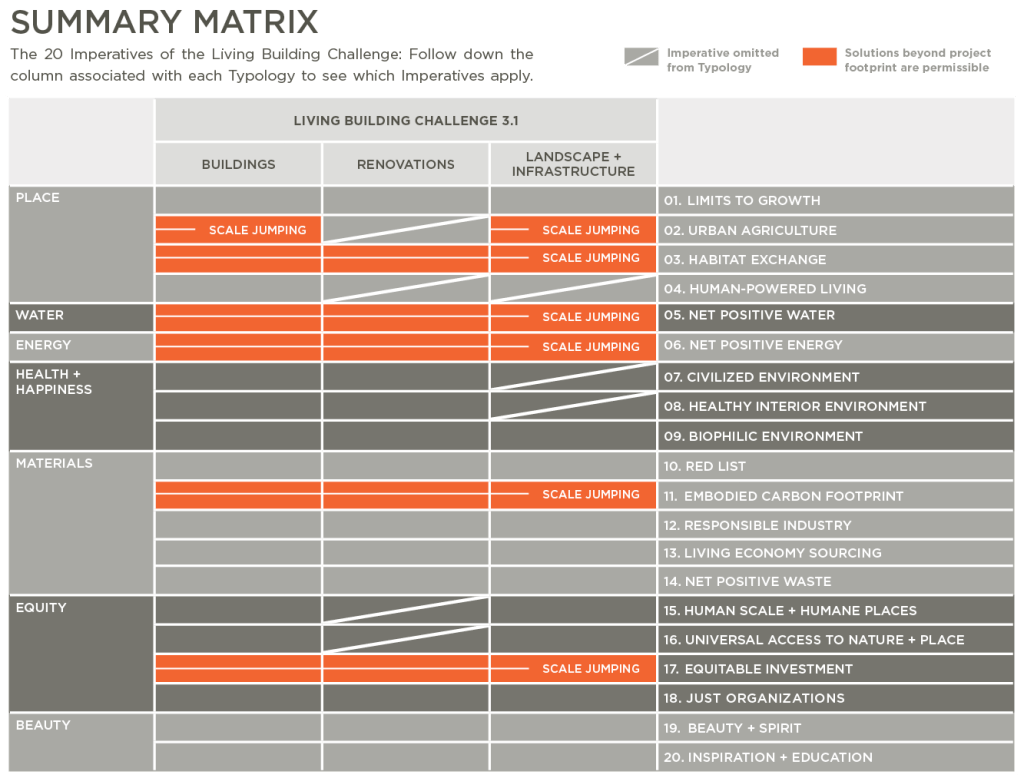

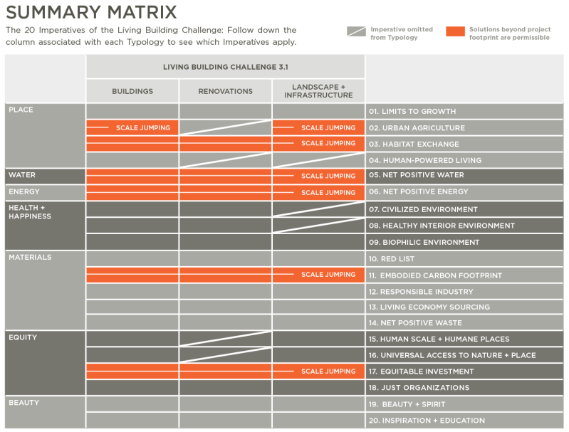

Architects and a small army of tradespeople made it happen in Santa Monica … and in Amherst … in Decatur … in Virginia Beach … and perhaps soon it will be realized in Accokeek. There are 11 buildings in the U.S. and Canada that have been certified under the Living Building Challenge (LBC)—the built environment’s most rigorous performance standard.
LBC combines requirements for net-zero energy and net-zero waste and water. And if that weren’t hard enough, the building can’t be constructed of toxic materials. In fact, one of the really helpful resources found in the standard (PDF) for all building professionals is the “Red List” of toxic materials and chemicals.
Unlike LEED, the Living Building Challenge requires actual, rather than modeled or expected, performance. Before an LBC building can be certified, projects must be operational for at least 12 consecutive months.
