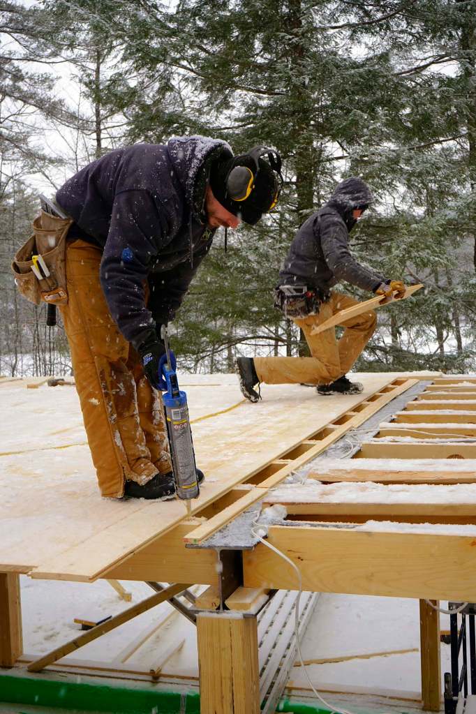

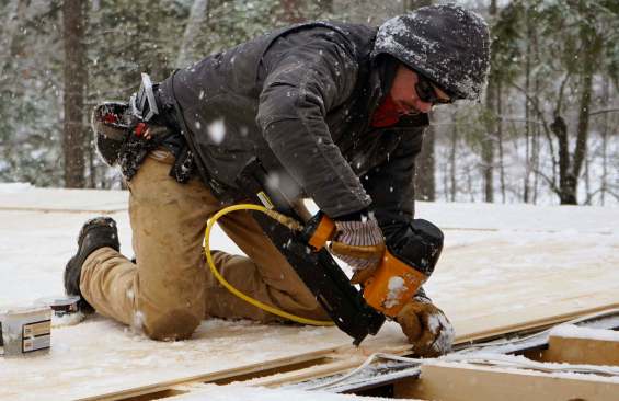

Carpenters Alex Strugatskiy (left) and Ryan Bielenda apply tongue-and-groove pine ceiling boards to sawn timbers as they deck over a lower-level living space for a pond-side home in the Maine woods.

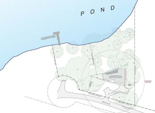

Nestled by the side of a pond in the woods, the site posed a design challenge for Sokol. "When I dug into the zoning of the property," he said, "I learned that there's a 100-foot setback from the water (which is typical), and then there's a 30-foot side-yard setback, and then there's a 50-foot setback from the road. So there's this little tiny wedge on the site that is buildable, and that's it. So if you look at the plan of this house on that site plan, it's shoe-horned right into that triangle."

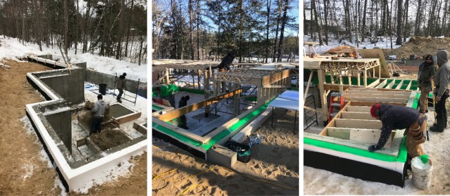

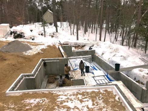

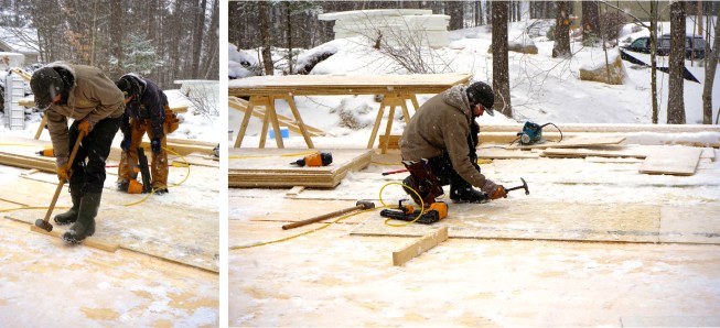

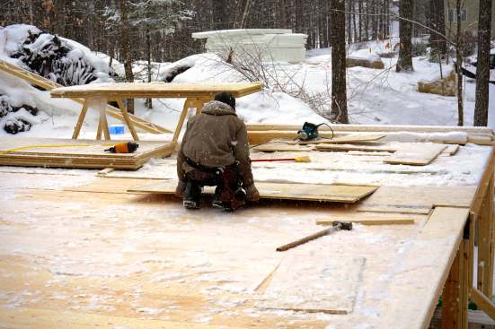

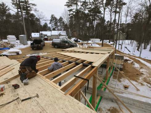

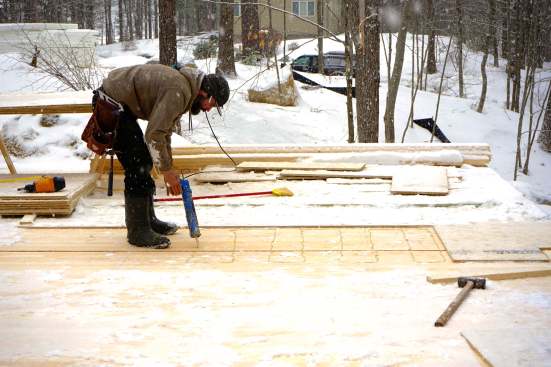

Sited on a buildable wedge between the road and the pond, the house steps down toward the water. Left, the foundation in place with the water side open; middle, the first framed floor under construction; right, carpenters frame the split-level entry on the uphill (road) side. (Photos by Jesper Kruse)

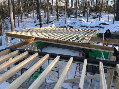

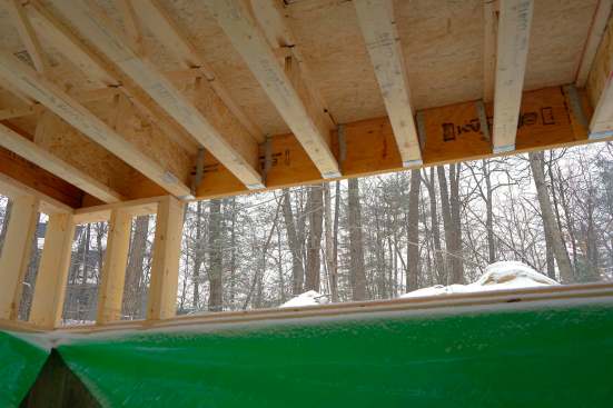

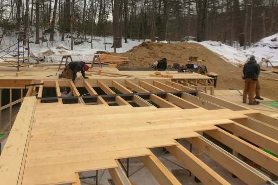

The resulting house has a staggered footprint, and steps down the gentle slope from the road toward the pond. The house may eventually be the owners' retirement home, explained Sokol, but in the short term it will serve more as a gathering place for social entertainment. "So you come in the front door, and it's like a split level," said Sokol. "You go either up or down, depending on where people are congregating. A lot of the time, they want to be hanging out in the lower-level living space. And from that space, they want to be able to step out right on the downhill side, just walk out onto the ground next to the water. So it's a true daylight basement."
These considerations determined the foundation and floor-framing concept, Sokol explained: "You have the existing grade on the downhill side, and then you come up enough to form the floor and the foundation. Then you need a certain amount of head room down there, and that kind of sets the first-floor height. But that first floor is 3 or 4 feet up above grade on the uphill side, so that's why there's a split-level entry."

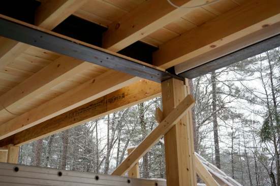

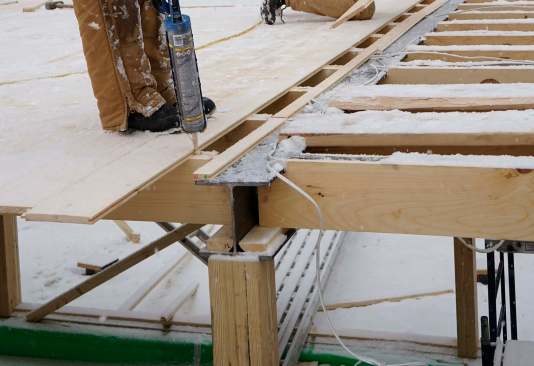

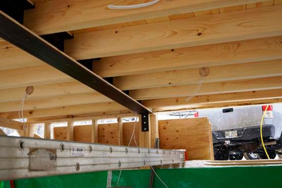

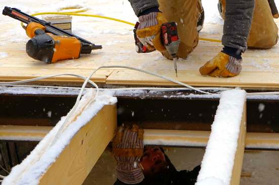

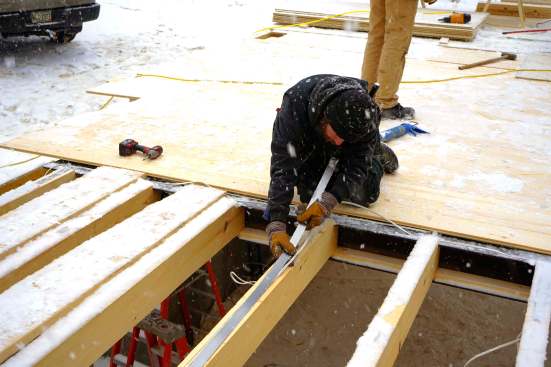

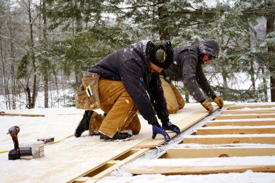

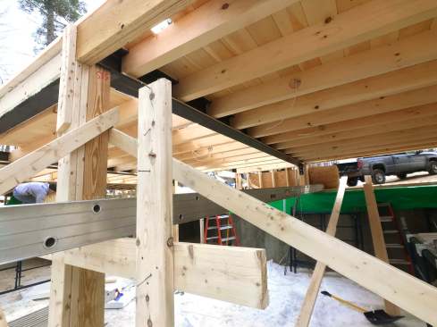

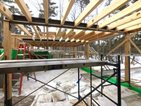

Working around steel structure and rough wiring, carpenters install ceiling boards onto solid sawn beams for a basement-level room, then apply Advantech panels over the boards as subflooring for the living space above.
Play slideshow

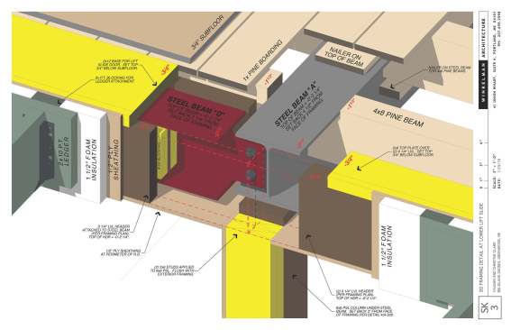

The lower-level space has exposed timber ceiling beams with tongue-and-groove pine ceilings—chosen because "it looks nice," said Sokol, but also because "it makes it feel a little higher down there." The lower level also has lots of glass, including a large lift-and-slide door facing the pond. All of this created construction challenges for Kruse and his carpenters (see slideshow): The exposed steel and wood structure had to be placed with care, and rough wiring had to be integrated into the beam assembly as the tongue-and-groove ceiling boards were installed, then overlaid with Advantech subflooring.
The complex footprint, along with dormers and bump-outs above, make the house too hard to frame using Kruse's typical wood I-joist built-out wall, said Kruse. Instead, the plan calls for double stud walls—and Kruse expects the result to fall a little short of the strict Passive House standard for energy conservation. Still, he anticipates an exemplary level of comfort, and he says that just like his Passive House projects, this building will be heated and cooled entirely by one or two mini-split heat pumps.
