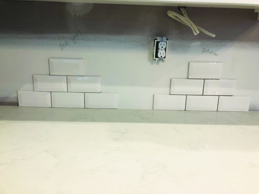

From that point on, mock-ups have become an essential part of our selections process. One simple example is the time we turned an entire wall into a paint sample, giving our client plenty of time to examine the color in different light. Another time, we installed a few square feet of a chosen tile, but with different grout colors. We often quickly trim out a couple of windows with different interior and exterior casing details so clients can see how the profiles look in real life and compare them. We worked on a much larger scale on another project, erecting a 3,000-square-foot full-size walk-through portion of a new home that we were about to build. No matter the size, each mock-up serves the same purpose: to provide the client with enough detail to feel confident about their selection and avoid re-dos.

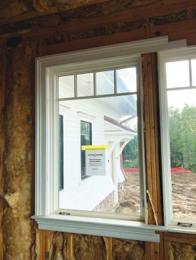

Before drywall installation, interior and exterior trim options can be mocked up.

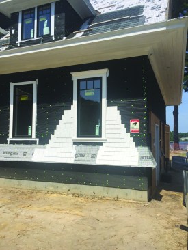

Selecting siding color is also easier when it’s seen in natural light.

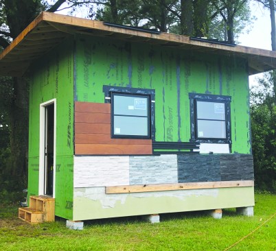

This small structure started out as a jobsite office but soon became a perfect place to test different combinations of windows and claddings.
Recently, we discovered another benefit to our mock-ups: installation verification. After evaluating the schedule for an upcoming project, we decided to build a small, on-site office. Our intent was to keep it simple and dried in, but it didn’t take long to realize we had just constructed the perfect mock-up scenario: a shell that could not only receive different exterior wall claddings, windows, stone facade design, cornice details, and roofing but also serve as a testing platform for the installation of each component.
As design and selection ideas for the project progressed, so did our mock-up, which has been crucial not only for the aesthetic evolution of the project but also for the building envelope’s design. We have a platform to test the performance and integration of key components of the project, such as the Parklex rainscreen cladding system, flangeless windows, concealed gutters, metal roofing, and more.

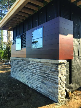

A thin adhered stone veneer in various colors and a rainscreen cladding system are mocked up.

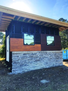

A full-scale mockup allows clients to visualize the difference between raked and full mortar joints in the stone cladding and the mitered Parklex cladding corner detail.

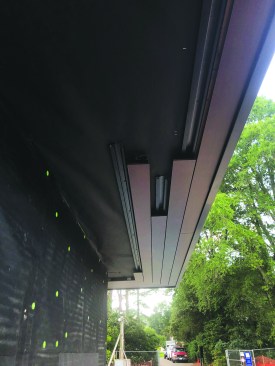

Clients could see the effect of using a narrower, 4-inch version of the cladding for the soffit.
Our mock-up also gives our team a chance to “practice” installing new materials with new methods. We’ve seen this lead to more productivity once we begin the actual installation, because we’ve had the time to work out unforeseen issues that sometimes arise with unfamiliar products. For example, we’ve been able to fine-tune the window positioning with the wall cladding panels, which have a double-rail mounting system that creates a nearly 3-inch gap between the face of the sheathing and the exterior face of the cladding.

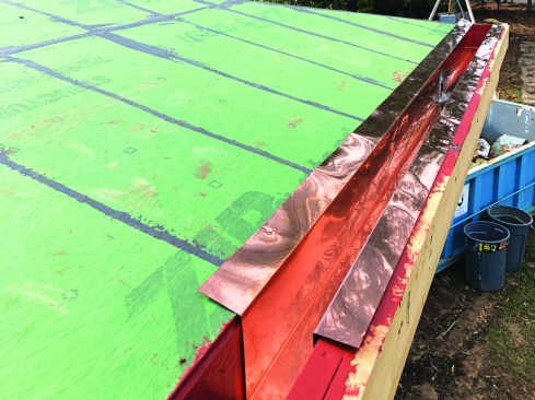

Is our “mini-house” overkill? We don’t think so. Like the majority of our clients, the owners don’t design and build residences every day, and the choices and questions we present to them can be unfamiliar and challenging. Our approach eases their stress level, and they no longer feel the pressure of “speak now or forever hold your peace” before making a commitment to any selection. And it gives our trade partners the chance to work out new details, such as the concealed-gutter design that we first learned about in JLC (“Concealed Gutters for a Modern Lake Home,” Aug/18).

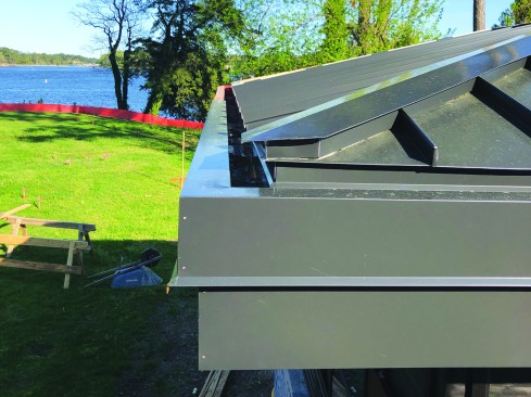

The roof has a wide overhang with a copper-lined hidden gutter.

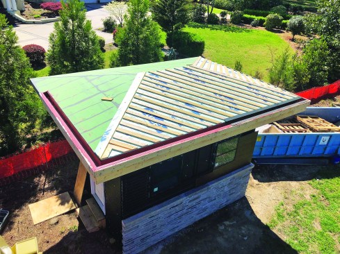

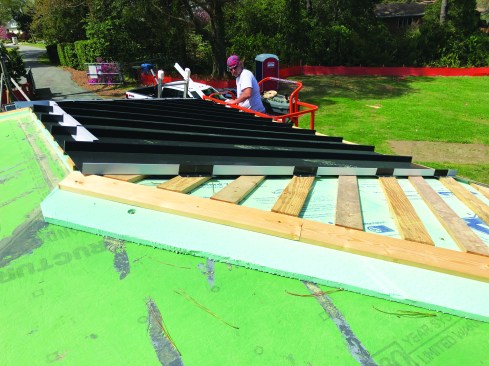

The crew tested a standing-seam roof installation over sleepers, rigid foam, and sheathing.
The panels deflected even with sleepers installed on 8-inch centers.
The final decision was to eliminate the foam and separate the panels from the sheathing with a high-temperature underlayment.
