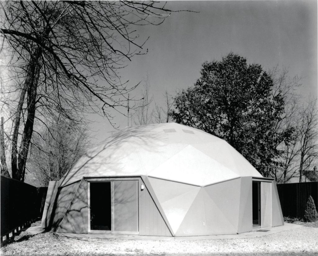

Built at a cost of less than $8,000, the 37-foot dome seemingly lived up to the manufacturer’s claim that it “provided maximum space at minimum cost, in a revolutionary ratio.” Unfortunately for its inhabitants, it also leaked.

Fuller’s personal 37-foot dome home was reportedly erected in a mere seven hours at a cost of less than $8,000, but things went less well after that. According to Carbondale architect Thad Heckman—who is active in a group (fullerdomehome.org) that plans to restore the dome later this year—the structure apparently leaked like a sieve from the beginning. “As far as I can tell, the only seal between the panel joints was tape and a coat of paint,” he says.
Because “Bucky,” as he preferred to be called, spent most of his time traveling, Ann Fuller presumably spent more time dealing with the leaks than he did. Perhaps at her instigation, the exterior of the dome was sprayed with urethane foam in an effort to make it water­tight. That attempt apparently failed, because several years later the foam was peeled off and the plywood surface was covered with first one layer of asphalt shingles and then another.
In about 2003, the deteriorating dome was enclosed in a more modern dome, where it awaits structural repairs and a new TPO roof.
