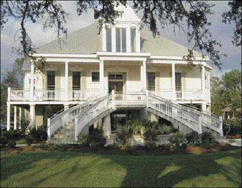

Justine, a plantation home moved to Lakeshore Drive in Mandeville, La., sits on a new 15-foot pier foundation. The renovated home was one of the few lakefront buildings to survive the surge rushing over the seawall when Katrina struck.
The storm surge washing over a 6-foot seawall on the north shore of Lake Pontchartrain packed nothing like the destructive punch of the 25-foot wall of water that scoured beaches and obliterated houses on Mississippi’s Gulf Coast, a scant 90 miles away. Even so, the Pontchartrain wave took its toll on August 29, 2005. From where I stood just two weeks after the storm, I could see homes and storefronts that had been battered into scrap up and down Mandeville’s Lakeshore Drive. By then, light traffic had begun flowing across the causeway past a now-quiet lake. The silence in the nearly deserted neighborhood was interrupted only by the occasional squawk of a utility truck’s two-way radio as a lone crew worked to patch in power.

A few houses down from the Borne residence sits another recent Lynn Mitchell project, the Justine plantation house (lead photo). Relocated from its original site on a bayou plantation (Figure 3), this building had been floated to Mandeville on a barge over Lake Pontchartrain (Figure 4) and placed on a new foundation on Lakeshore Drive, where it now holds offices (Figure 5). “That one did even better than Chip Borne’s house,” Mitchell said. “It wasn’t touched. Justine has become the poster child for FEMA around here.”

“Actually, it was touched,” jests Michael O’Brien, the general contractor on the project. “It kissed the ceiling underneath and knocked a couple of ceiling boards out. But yeah, it was basically untouched.”
Figure 5. Justine now sits on steel piles. The majority of the pilings were encased by concrete masonry units to FEMA specification (top and bottom), then stuccoed. In front, behind the stairs, tapered columns were constructed of brick and then stuccoed using a 2×4 as a screed and an adjustable metal ring as a template. The finished columns can be seen in the lead photo (page 2).
