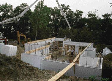

Energy-efficient ICF walls and foundations are long lasting and use less concrete than conventionally formed walls — two traits that kick them into the green category even though polystyrene and concrete aren’t obviously green materials.

Foundations and exterior walls. We’re the regional distributor for Reward Walls ICF wall systems, which have worked well for us because they’re easy for our carpentry crews to install. When we’re using a slab-on-grade foundation, ICFs allow us to pour the walls and the floor at the same time, reducing labor and pump-truck charges. The resulting concrete walls are much more durable than stick-framed walls and have an adjusted R-value of 33.
